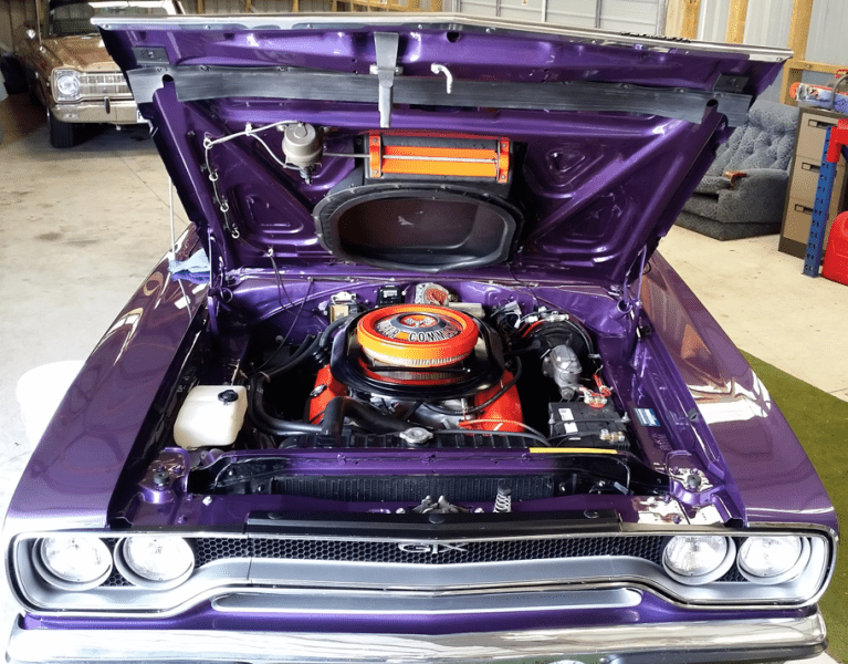

I am in the process of ordering a new engine wiring harness for my 70 Coronet. I know most people place the orange box on the fire wall or on the inner fender where mine is (pictured), as its close to the distributor. But, to preserve the original look as if it was a points car, has anybody located the orange box in hidden locations like under the battery tray for example? That's quite a bit of extra wiring length, but I would like opinions and pictures from people who have done this. I may as well get a harness made to suit now, rather than modify a new harness. I might opt to leave it where it is for convenience, but it does bother me. :rolleyes:
By the way, I know there are many non original items pictured in the engine bay, but I am in the process of returning it to stock appearance.

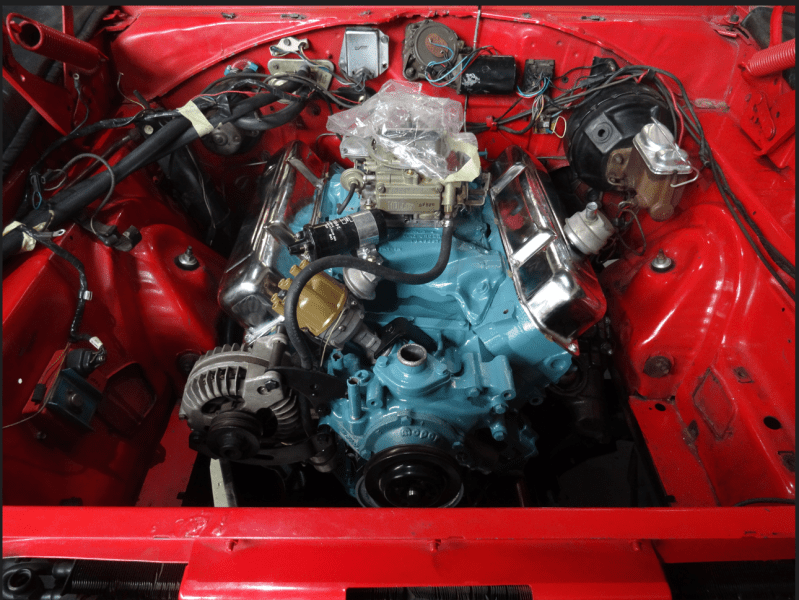

Here is how I mounted the Rev-N-Nator unit a few years ago....made use of the common hole and added one rivnut underneath.
(Please ignore the ugly Furd starter solenoid.....I used that while waiting for a replacement to arrive.)
