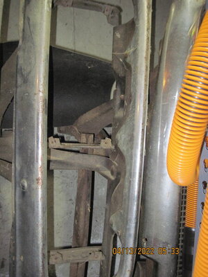

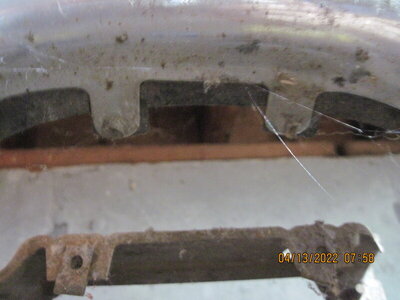

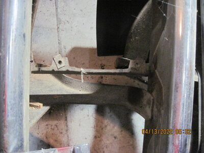

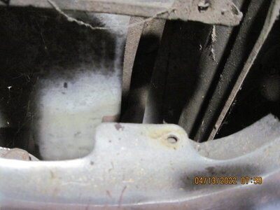

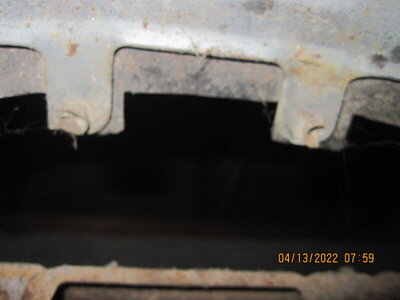

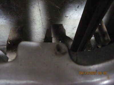

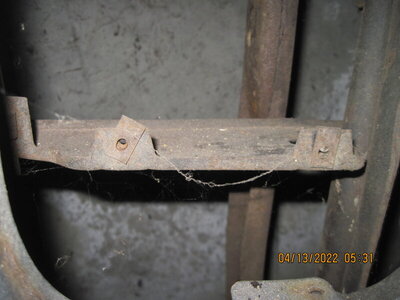

I believe this is what you are looking for and do you have any pictures of the nylon push screws

The only location I can see is on the inside edge of both ends of each bumper loop there are black plastic shields that are factory attached with rivets so I am assuming these plastic fasteners take the place of the factory rivets.
