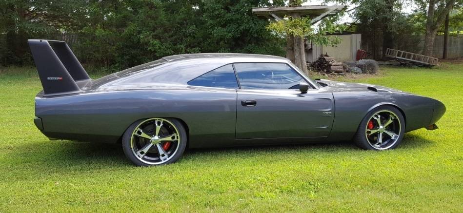

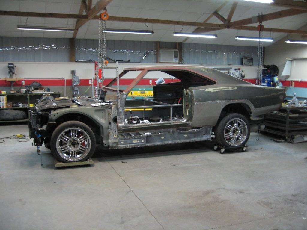

If you are interested here is a link to a Charger Daytona I spent the last four years putting on an LX platform. A Challenger would be better for a 1970 Charger as the wheel base would be closer to correct.
http://www.dodgecharger.com/forum/index.php/topic,101925.0.html

Factory should've done this. (Instead of a 4-door fleet car....)
Very cool, there's a member here doing the same that you should check out (sorry can't remember the name of the thread). I'd love to see someone pull this off without loosing that dished look on the rims, the modern flat faced rims just don't cut it for me.

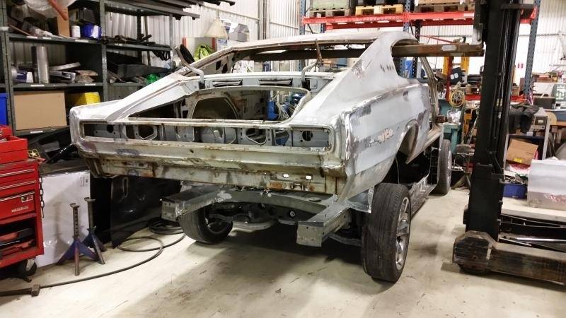

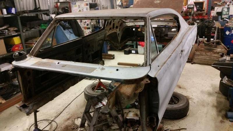

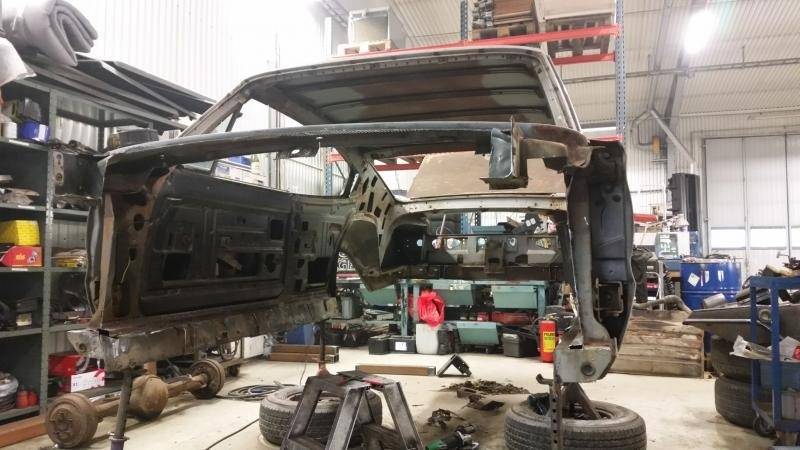

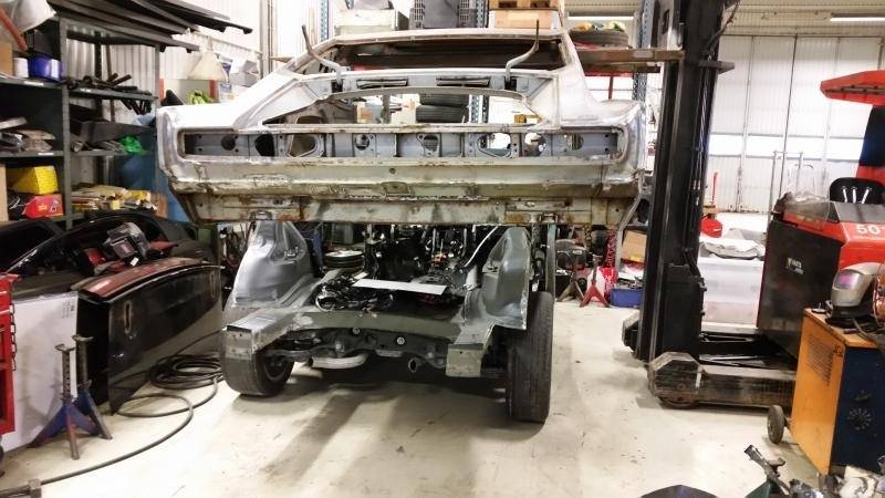

"We will be using this un-hit 2016 Challenger Hellcat shell to set the 69 body onto."
http://www.forbbodiesonly.com/moparforum/threads/charger-1967-2012.101047/

Can't find it in the search post a link

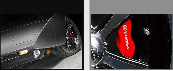

The hubs on the LX platform are set like most new cars to put the brake rotor about center line of the wheel so there is no room for dished wheels. The wheels I chose were a compromise in that the spokes are dished in then there is a an offset where they attach to the wheels the gives them a more dished look than most flat faced wheels. It was the best that could be done giving the fact that this is 50 lbs of car stuffed into a 5 lb bag. The equivalent of putting a 69 Chevelle on a 69 Impala platform.
