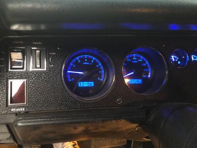

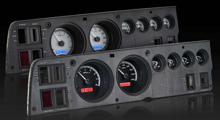

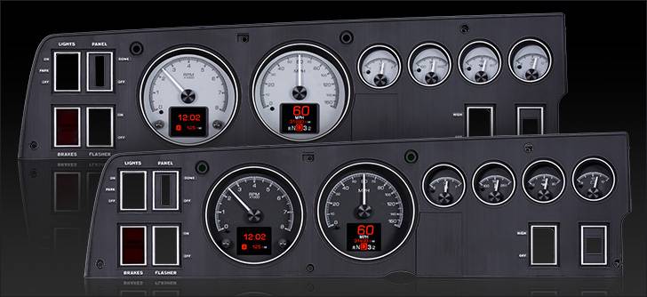

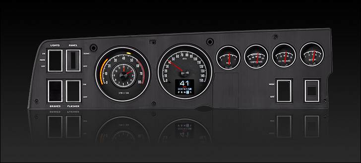

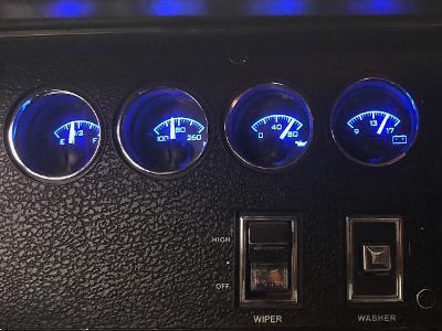

In my opinion, it looks cheap. I did it years ago and would do it on a beater car but not a Charger. Come on, man....spend the money and either get your gauges restored or switch to a Dakota Digital setup.
Thanks Kern this are all real nice. I really like the first one as it looks most like the original. Although if I did a lot of night driving, the last one is really cool too. I know eventually I'll have to upgrade.
