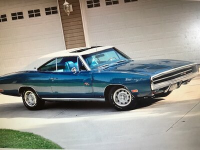

Hi guys,
I have a nicely restored 70 Charger R/T SE factory sunroof car that's an OE Silver winner. Most recently I've been trying to put some miles on the car and work out some of the bugs. One item I need to address is how the transmission is shifting. It's shifting very quickly and not allowing the engine to get up into the RPM range. It's in drive before you reach 15-20 mph. It's the original 727 trans, linkage and Carter AFB. Nothing fancy here, just original parts. When I had the transmission rebuilt I told the guy to rebuild it to factory specs and just "spruce up" the shifting a tad, that's it. Any guidance would be greatly appreciated as the last thing I want to do is burn up the transmission. I only have about 100 miles on it since restored and most of it is to/from the trailer or show. I welcome any feedback or documentation you're willing to share. Thank-you
