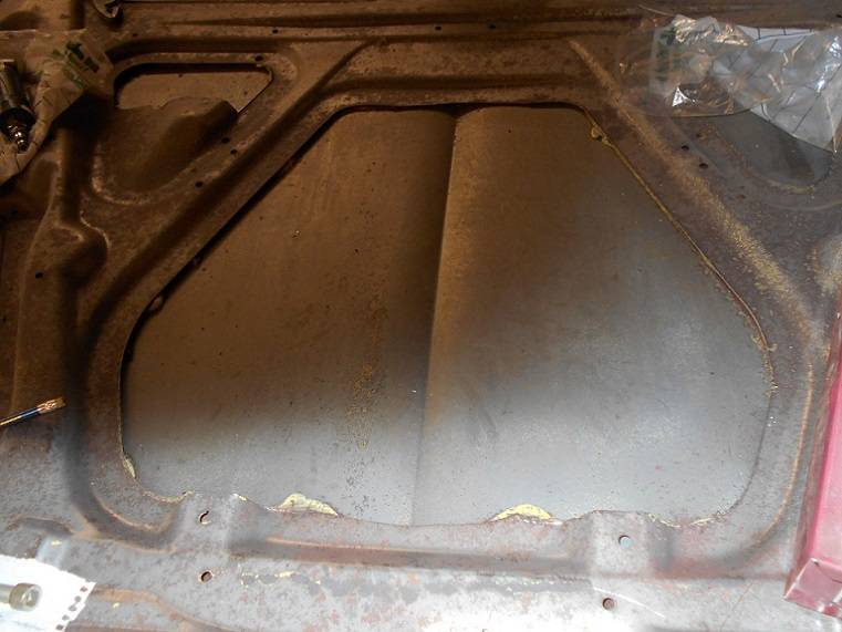

Ive just came across a complete original 70 ram charger box & a complete breather that mounts under a 70 Superbee. I planned on converting a flat hood to ram air. But a couple of well experienced Mopar guys have told me that the bracing underneath the regular flat hoods are different in some way. Does anyone here have a pic of underneath of a regular flat hood or that can tell me the differances if any? I thought the only differances were the rectangular holes needed for the s oops to mount at?

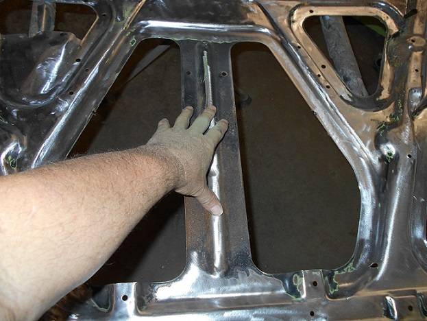

Here is my thread on the ChargerBoard.... top is regular hood, the bottom is Superbird which would be the same as N96 Fresh-Air hood
http://www.dodgecharger.com/forum/index.php/topic,130625.0.html
Also has holes for bolts and clips.
