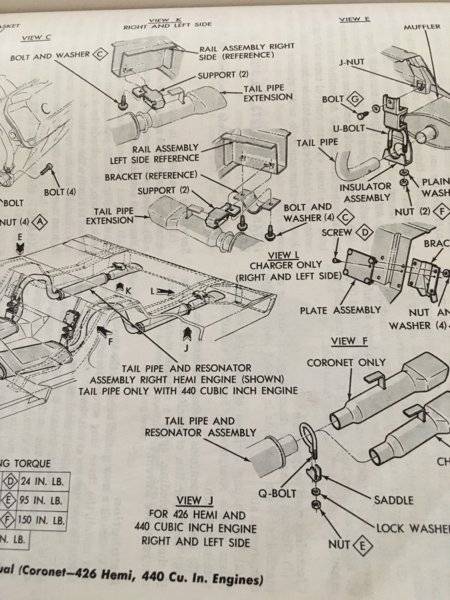

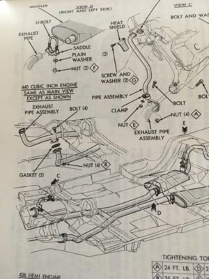

Pics for ‘68
DC98B97B-23A2-4983-BBD3-7A0F688CD91D.jpeg 4197CF3A-760B-4A0F-997B-9CDC38EE0220.jpeg
From what I know resonators change the sound but it may not be much quieter.
If you want it quiet add them anyway. I added them to my Challenger and it is a bit quieter.
My personal experience there.
I think the best thing is add an X or H pipe I saw a test with a decibel meter and adding the crossover reduced the noise by 10% and no loss of power. The X pipe was quieter than the H pipe but only a little bit.
There is a reason all OE exhaust dual systems had a crossover if they could of left it out and saved money they would have.
