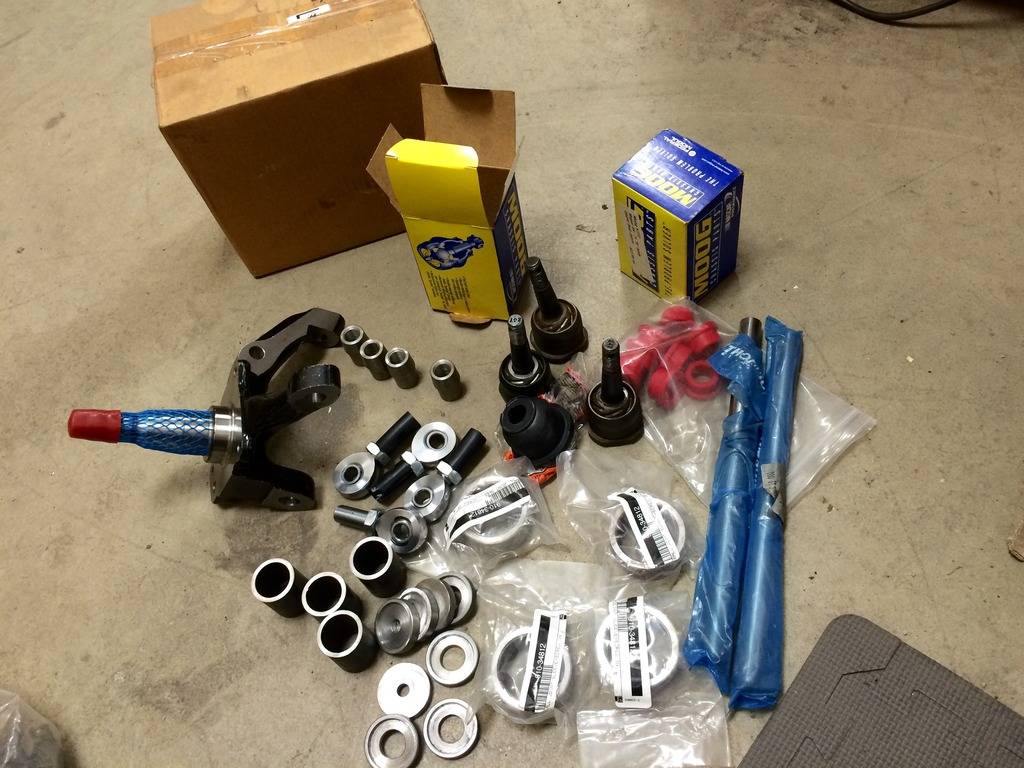

Front suspension in a box, just add a rack and A-arms!

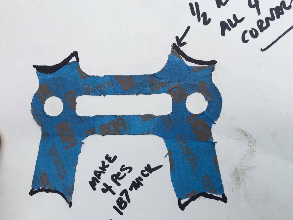

I made the template for the lower shock mount. Now I just need to cut them.

Plasma or laser, looks like plasma.
It's plasma. I know another guy with a laser, but he usually wants a CAD file and then I have to wait until he runs a batch of that thickness material and hope he has room to nest it in. The plasma just needs a little edge clean up here and there and it's good enough. The hole quality isn't near as good as laser either, but it will work fine. I cut four as I'm going to do two sets of LCAs. One set with lower bushings like the Alterktion uses and one with spherical rod ends. All my Ford friends run rod ends on their aftermarket uppers and lowers.
