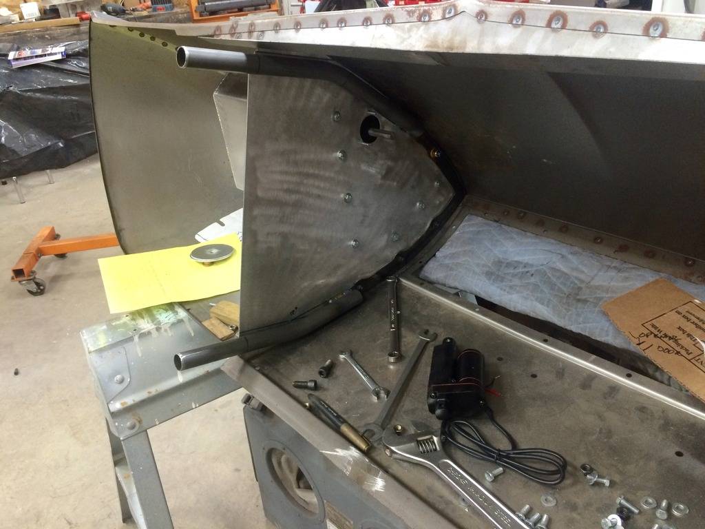

Here's how it'll go in the nose.
And how it looks inside the bucket.

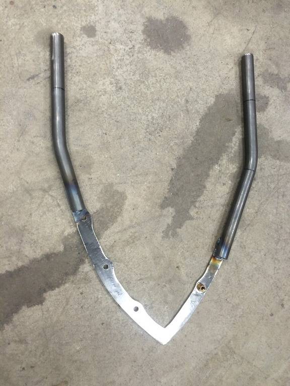

After all the work on the nose, I came up with a new mounting strategy. It will consist of four tubes(two on each dividing panel) that telescope into receiver tubes and pin into place. The receiver tubes will be extensions of the intercooler mounting tubes. The beauty of this design is.. Pull 4 pins and disconnect the wiring and the whole nose pulls off for easier access to the engine or headlight mechanisms.

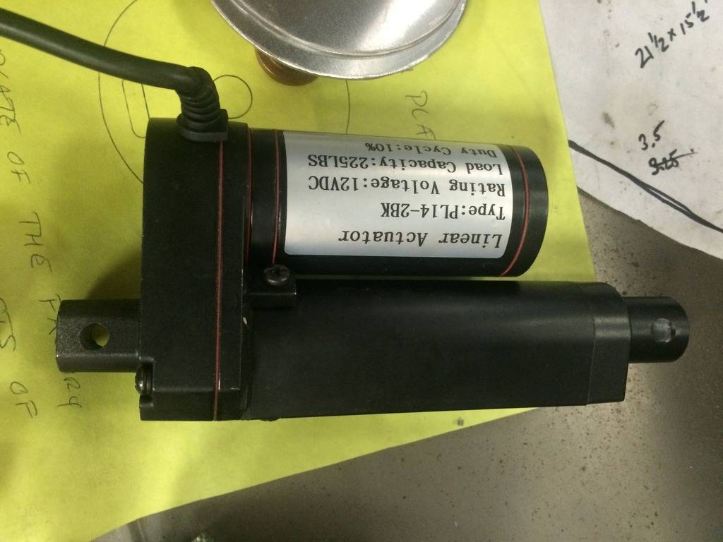

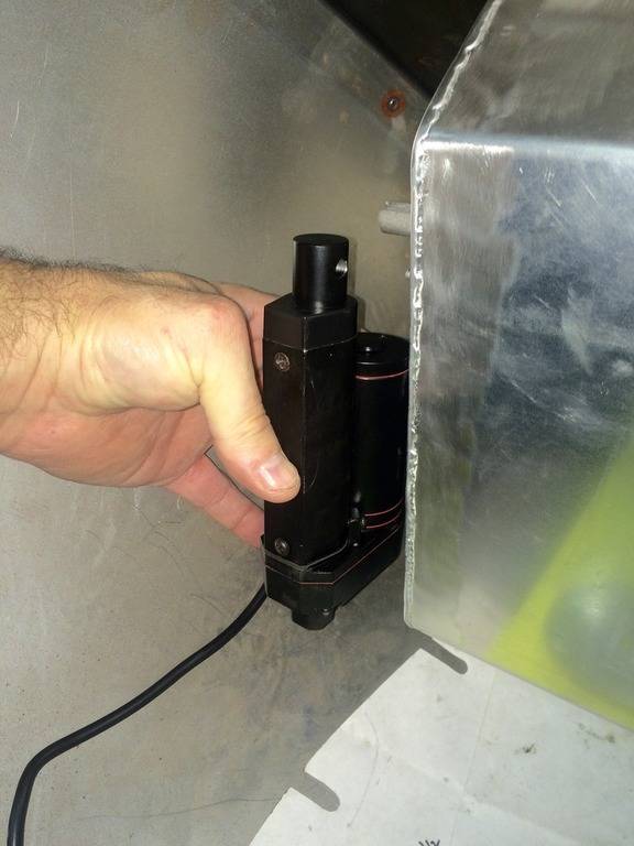

This nose project is the gift that keeps on giving. Giving me fits, that is. I got one mount bar welded together and bolted in. Looks like it should work well. The linear actuators showed up as well. You can see my idea for mounting. I need to get my pivot adjusting plates done so I can determine a lever length. These are cheap ebay units and don't have internal limit switches so I'll have to add those.
