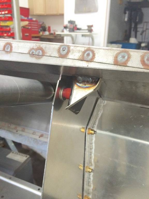

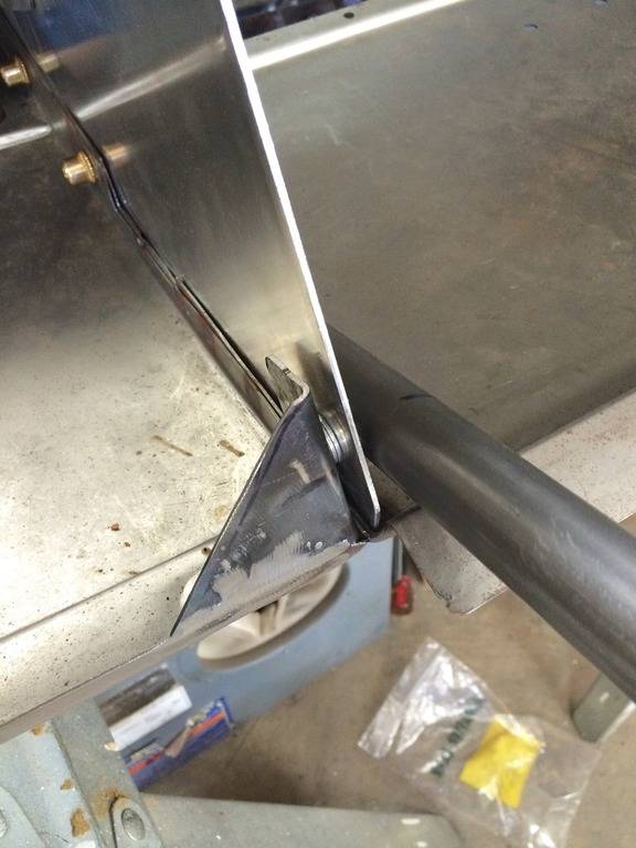

Had to add some gussets to the nose to solidify the mounts.

For those that might be confused on how this nose will mate up to the body, this photo should help.
These tubes will go inside some tubes extending off the radiator yoke. Hopefully I'll have some time around the holidays to finish the mount bars.

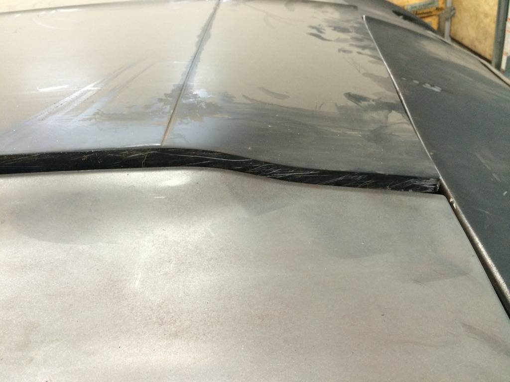

Well that didn't work out. Turns out the bottom of the hood is hitting the bar.
No worries though as I have a solution that will probably be more pleasing to the eye but it will have to wait until the weekend.
