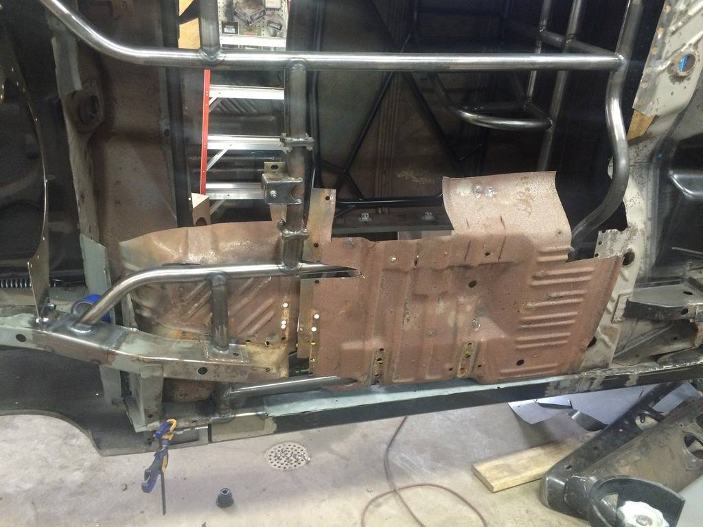

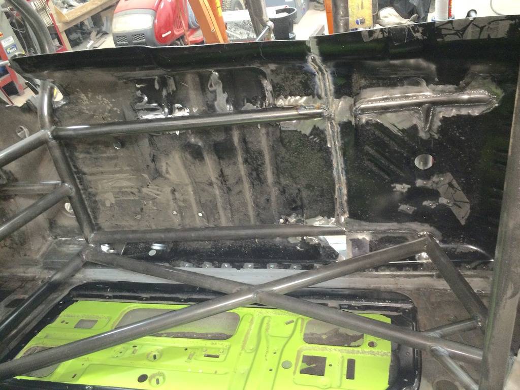

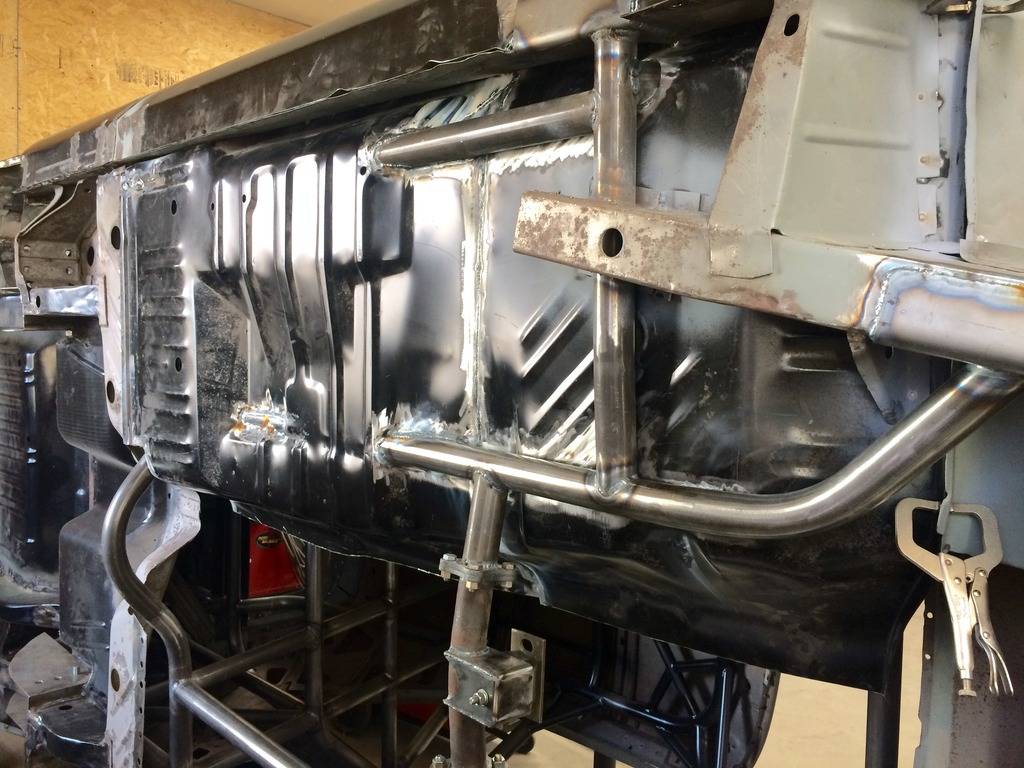

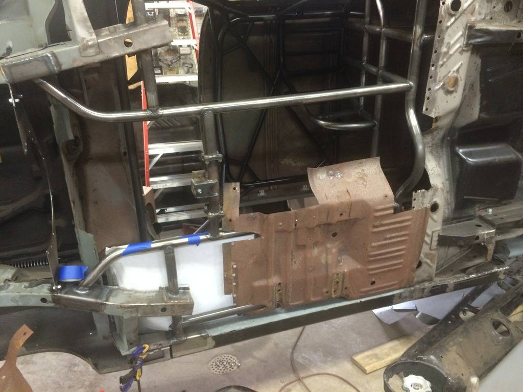

Started fitting floors using the old ones as templates.

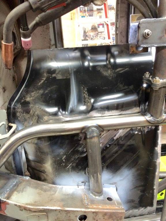

The foward one needed a posterboard template made to locate the A-pillar bar's location.

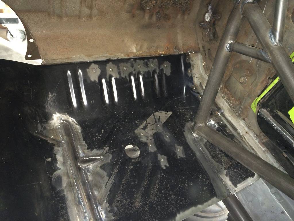

Once I had those fitting decent, I transferred the patterns to the new floor.
One entire weekend spent on half a floor....
Before the other half goes in, I have to do a transmission mockup again and make sure the tunnel will be large enough. My guess is that a two inch wide strip will need welded in. The rear drive shaft tunnel gets cut back out and a larger oone put in along with a couple more drive shaft safety loops.

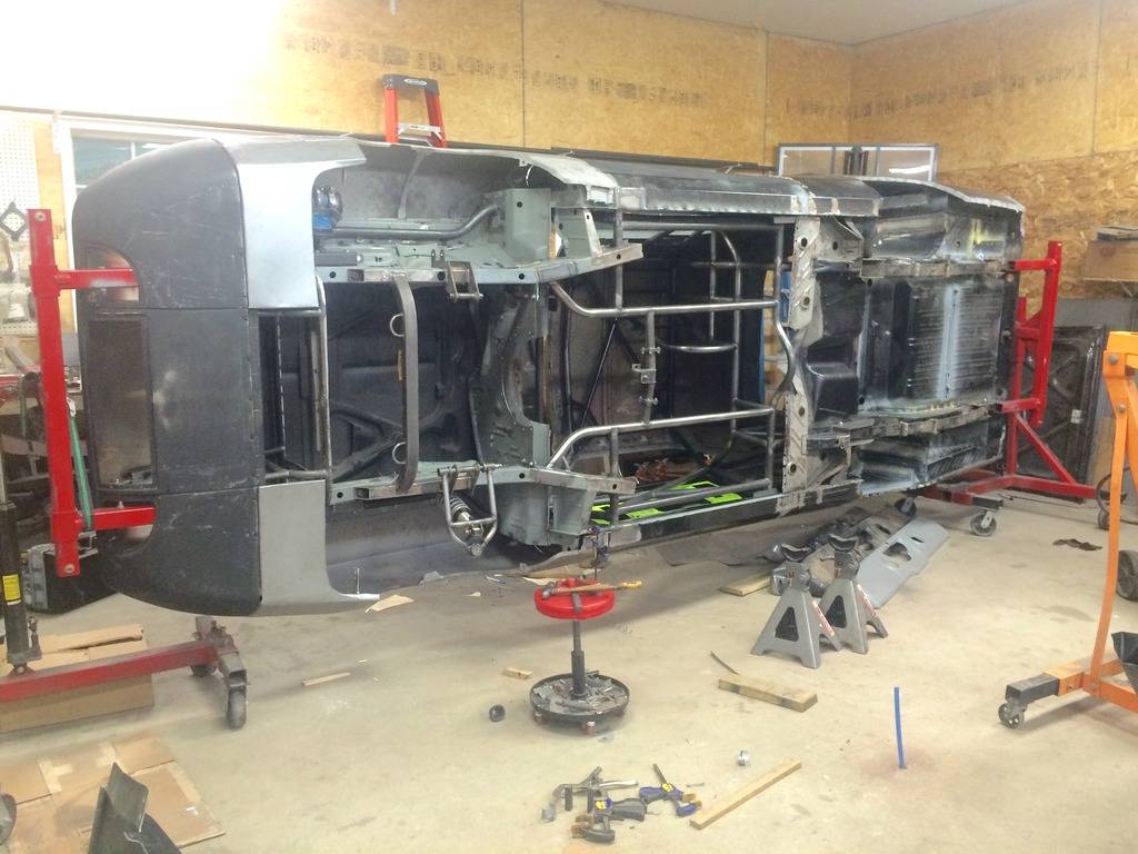

Are you going to install frame connectors or rely on the cage?
The cage is 1-5/8" OD .083 wall 4130 chromoly. There is a rocker bar and an inner frame rail. Both are integrated into the floor. Anything beyond this would just be added weight. With the dual tube rear frame rails in the trunk, the factory frame rails are really just along for the ride. The front frame rails are the only functional part of the original unibody.
