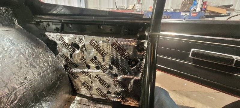

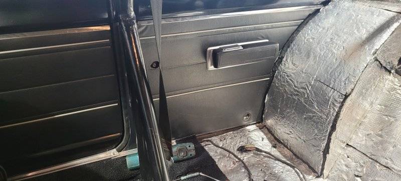

Did a little bit on my car rear panels needed sound deadening, but the paint on the metal panels didn't turn out well,so I have to resand them and paint again.

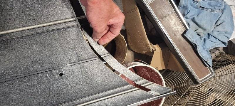

Passenger progress,I need to modify window cranks they. Will hit the roll bar, already modified the door cards to fit around tubs and the stainless trim.

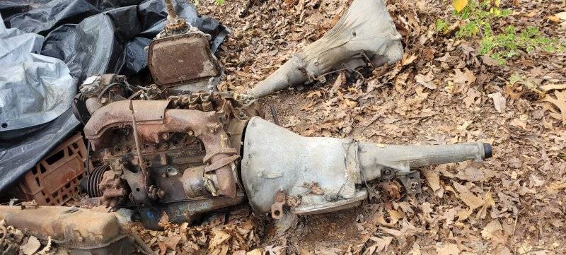

I have access to several different transmissions, 62-70 or 71 up which is preferred, originality isn't a concern.

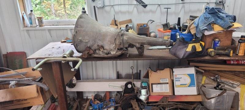

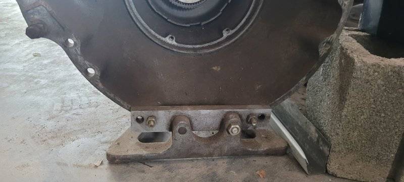

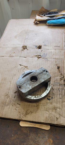

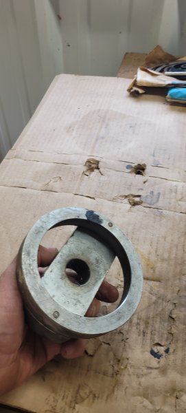

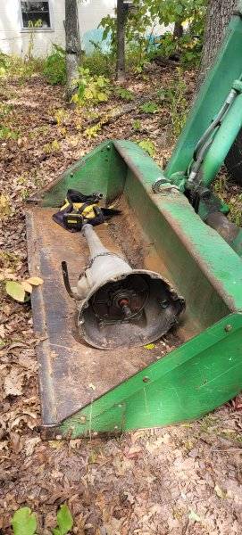

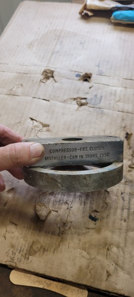

So I identified a transmission to build #4028412 is a 77 for 400 hp . I also unbolted it and put it on the bench, found some tools to work with, that were my dad's, I'm sure he has more once I locate them.
