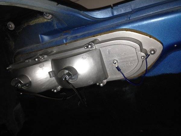

Are your tail lamps grounded ?
I will check in the morning. I did order a turn single switch harness today.Are your tail lamps grounded ?

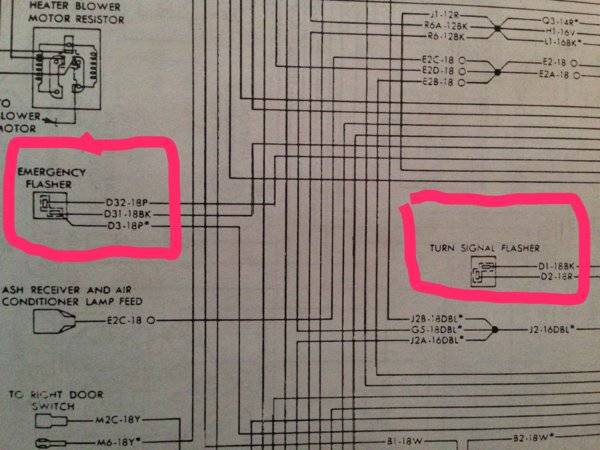

Purple beeper, I looked again today at the wiring diagram. I see the two flashers you are referring to. I'm only able to find the flasher for the hazards. Are they identical in appearance? (Hazard flasher and turn signal flasher) according to the schematics they look like the same plug end. Hard to trace wires when they are in a bundle all wrapped up. Might have to tear some of the wrap off and get a good visual where they go. That won't happen until Friday unfortunately. I will put the new harness in and put the column back together before any more destruction. I was told there was only one "flasher" by Napa.Hmmmm...... I wonder if the broken horn wire shorted out the turn signals? The horn ground wire is a short black wire that you can see if you remove the horn cover from the steering wheel. You can test the horn itself by running a long jumper wire from the + side of the battery directly to the horn connector (the horn is grounded to the body by it's bracket) & it should "beep" if its good. From there, I think I'd replace/repair the wiring and if that didn't work, replace the horn relay.
For the turns signals, maybe just look at the wiring diagram & trace the power? Somebody here might post a link to factory wiring diagrams & if they don't send me a private message and I will e-mail the diagrams to you. These guys are right about grounds too....I've had TONS of ground wire issues & I even ran a separate ground wire to each of my hood turn signals.
Oh yeah, and replace the flasher itself. That's the problem with mine right now. Neither turn signal works & it's my flasher for sure (you have one for turn signals + another one for the emergency flashers)
Hey Ethan, are those tail light housing ground wires stock????Yes, WilE they do appear to have a good ground. Inspected them. They seem to be clean and making solid contact
Hmm it looks like it's grounded to itself. You have to run a separate ground to the body.Yes, WilE they do appear to have a good ground. Inspected them. They seem to be clean and making solid contact
And will do absolutely nothing if your grounds aren't good. Run an alligator clip from the lamp housings to a good clean ground before you waste your time doing anything else.I will check in the morning. I did order a turn single switch harness today.
Replaced the hazard flasher at the beginning of this hassle and everything stayed the same (only the hazards worked) found the other little relay (turn single relay) and HELL YA everything works. I didn't get my book until last Friday and glanced at it here and there and realized there were 2 separate relays. Thanks I would still be tearing **** apart if it wasn't for you guys. APPRECIATE all the help fellas. The lights on the hood don't work but I got other things to fix before I worry about those. At least I can drive it legally when the time comes (more for my sake) hate to side swipe a carYep, TWO separate flashers. Shorthorse has a good point.... try to tackle each job one at a time, but I'd still take a look under the horn cover to see what I could see based on the last owner saying the turn signals went out when the horn did.
Stock setup? Anyone?Yes, WilE they do appear to have a good ground. Inspected them. They seem to be clean and making solid contact
I am unsure what they are. They do look nice and clean back there thoStock setup? Anyone?
Exactly. Do not rely on the metallic housing of the taillight fittings to provide a good solid ground - the best ground is found under a bolt directly on the welded body work. A good jumper wire between the housing and the bodywork should be added also.Hmm it looks like it's grounded to itself. You have to run a separate ground to the body.
