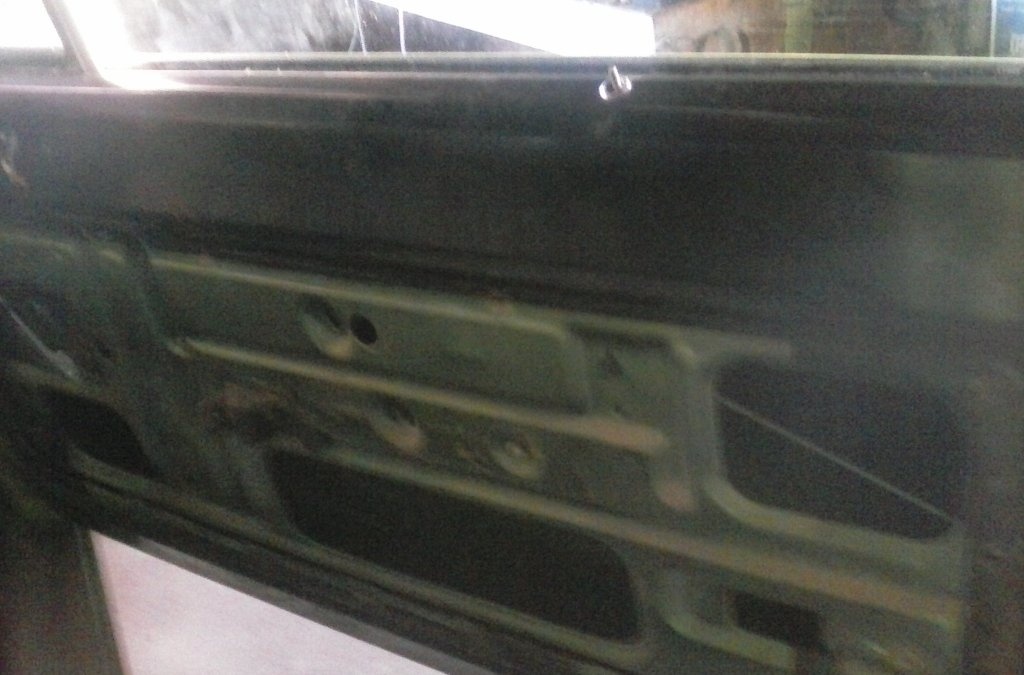

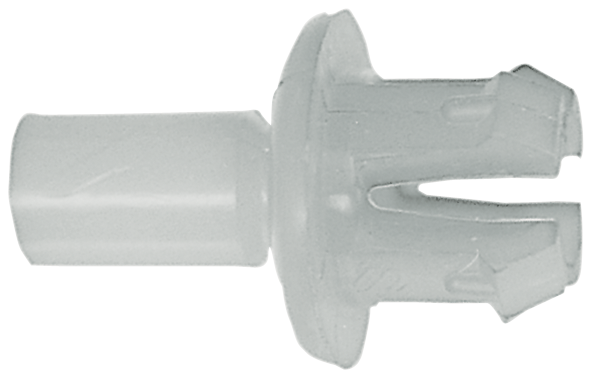

O.K. Almost afraid to come back without Pics. Photos will come Thursday. Long story. OK, I rejoice, door is open! Ordered plastic rivet to attach window to bracket. Is there a bushing/grommet that fits hole in glass? The hole seems a little large for plastic rivet. Have detail in YearOne that calls out rivet but looks like it uses a bushing/grommet. There is a Window regulator arm fastener listed but it has the look of a snap on washer. Have two window rivets on order. Thanks all. Photos will come, I promise.
It is a plastic rivet that is a window stop. I had to replace one in my 69. Looks like this:
Available here:
http://www.mrmoparts.net/window-glass-rivets-62-72-a-b-body/
