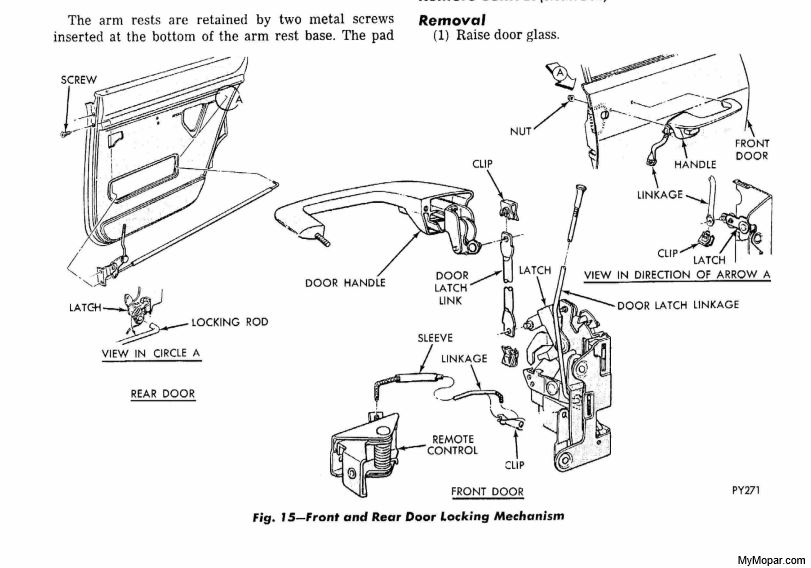

Roll down the window and fish a coat hanger with a small hook down the latch side of the door. Shine a flash light down the crack so you can see what you are doing. You will see a latch on the back side of the striker with a small ball on the end of it. This is where the linkage should have been. Pull it or push down... I can't remembered which way but I think it is up and the door should open.
He's right it is UP, and the door should open.
Having a hard time remembering why the inside door release wouldn't work,'cause it's a horizontal pull thingy that should still be connected unless that falling window was especially evil.
Does this help at all?
