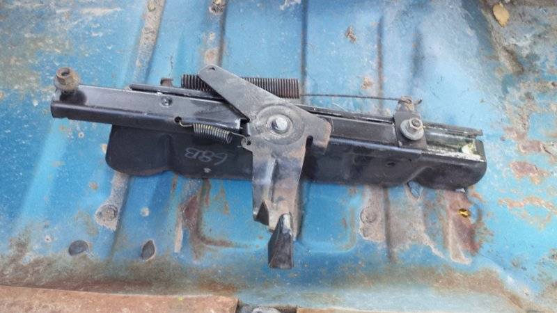

This probably doesn't really prove anything but here is a 68 bench seat track in the correct holes of a 70 pan.
