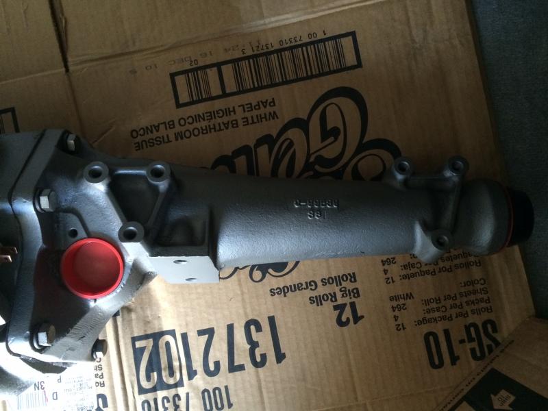

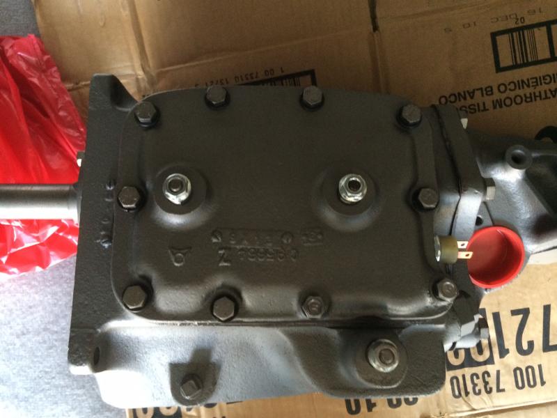

UPDATE- WENT TO PASSON TODAY !!
So I took the 300 mile round trip today (okay, slight detour to go to a gun show too :) and met with Jamie Passon. I brought him my A833 to take a look at and glad that I did. As a reminder, I was thinking of rebuilding it myself or having him rebuild it. Jamie pointed out 3 major and one minor issue. 1-I had a 69 tailshaft which would not have fit the trans cross-member properly in my 70RR, so I would have had to change the tailshaft or cross-member. 2- Second gear was shot, so had to replace that. 3- input shaft was worn, so would have had to change that. 4- one synchro ring was cracked which would have been replaced on the rebuild anyhow. My options were tackle the whole rebuild myself and source those parts, let Jamie rebuild it, buy a rebuilt unit from him, buy one of the OD units he has on special. I decided there were too many issues with my unit to rebuild it myself, even before tearing the whole tranny apart, so I decided to buy one from Jamie. Next decision was a stock 833 or an OD 833. My concern was the fun factor. Would I lose too much oomph with the 3.09 first gear to 1.67 second gear in the OD unit? I decided it wasn't worth the tradeoff. I'm doing this conversion because I want to have fun with the 4 speed and if I have lag shifting from 1st to 2nd with such a big ratio spread then I defeat my purpose right from the get go. The 4th gear cruising was never an issue for me as I do very little highway/long distance driving with my car.
All that being said, Jamie had a correct rebuilt stock 833 in his shop. It would have cost me the same to have him rebuild my unit as it did for the rebuilt unit he had in stock with him buying my 833 as a core. So, I left his place with a correct, totally rebuilt 833 ready to put into my RR. I feel very confident with the unit I got from him, especially with a 12 month warranty and I didn't have to make another 300 mile round trip to pick up my rebuilt trans. Also, I want to say that Jamie is a heck of a nice guy. He was happy to answer my questions and explain things to me, going over some pointers and questions I had about my conversion. Do not hesitate to do business with him.

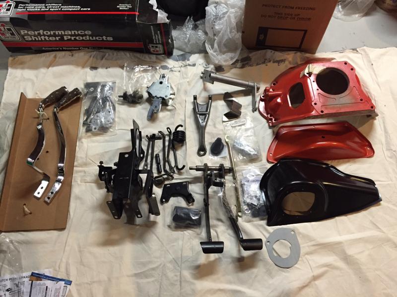

Life got in the way last year and I was not able to do my conversion. However, I am doing it later this month. I finally sourced the rest of the parts and have everything except the shifter boot and bezel (will get repops I guess). I made the decision not to do it myself. I realized I didn't have the tools, the skill set or the time to get it done right. Plus, I don't think my neighbors or the town would have let me leave my car in my driveway up on blocks/jackstands for the month/s + it would take me to do it without a lot of hassle. I am having Jamie Passon do the conversion. I bought the rebuilt 833 from him. When I was at his shop picking it up last year, he was doing a 68 or 69 RR conversion/reconversion. I think the owner put in a Tremec and it was a real butcher job. Jamie and his crew were putting right what was wrong. I was speaking to his one mechanic who gave me a rundown of what they were doing. He def knew his stuff so I feel confident they can do mine right. I have a console automatic now, but I'm removing the console and installing a buddy seat I got from a member here. Jamie will weld in the brackets when he welds in the hump for the 4 speed. One of the big drawbacks of me doing it myself was I didn't have a welder and have no experience welding. Also, I will be putting in sound and heat insulation (Dynamat type but less $$$) myself and replacing the carpet when I get it back.
It's going to cost me some $$$ to have him do it but I know it will be done right !!! I am going to sell the console, shifter and 727 to try to recoup some of the cost. Also, it will only take a few weeks for him to do it so I should have the car back with my 4 speed :) by the end of May. I'll give you all an update and some pics when I get it back. Wish me luck !!!!
PS- Here's all my parts except for clutch and flywheel.

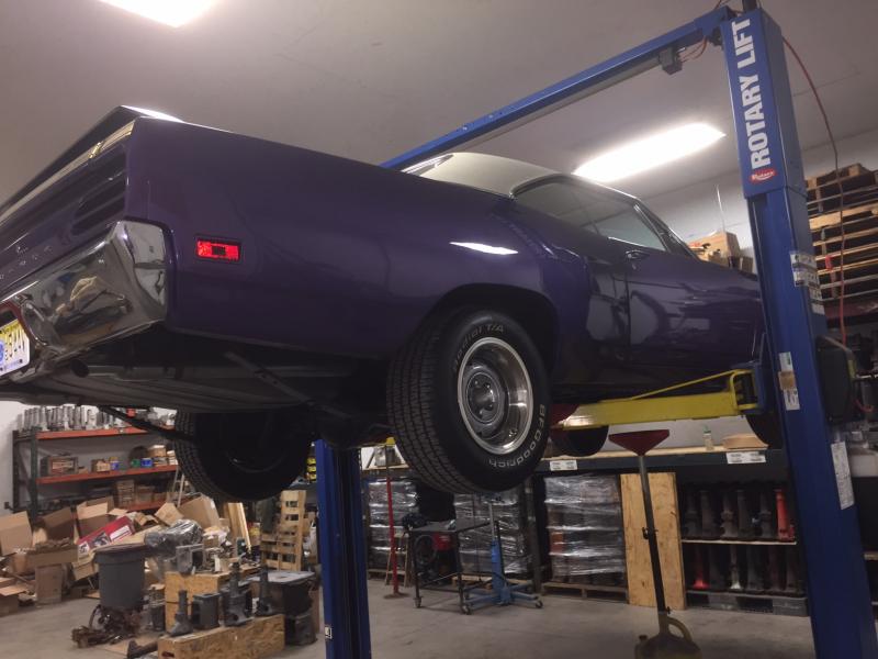

Dropped the car off at Passon yesterday and met with Jamie and his crew. He put the car on the lift after going over the exterior of the car and documenting the condition ( for his protection and mine- if there's any damage to the car upon pick up, I'm protected. If I claim damage was never there before, Jamie is protected. He got screwed once by this. Smart to document it.).

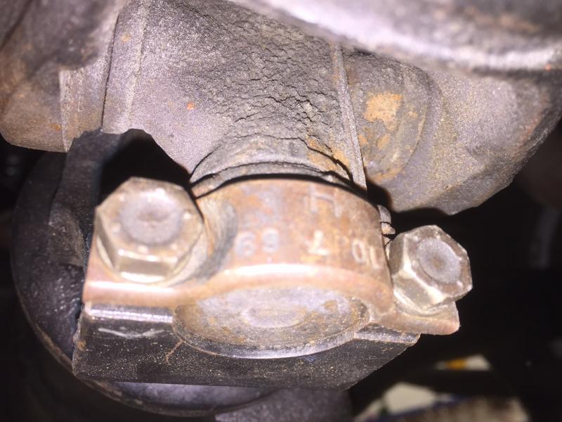

Jamie inspected the entire drive train from trans back. Noticed that there was some play in the u-joints, so replacing those too. He thinks the rear ujoint is original to the car- date coded and has wire on it (see pic below).
