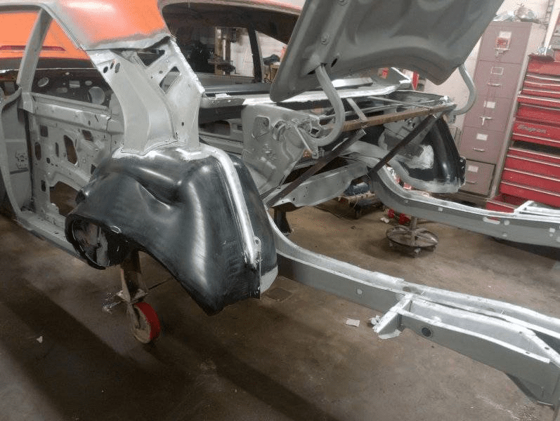

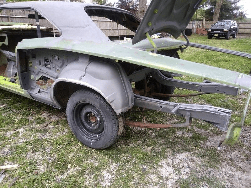

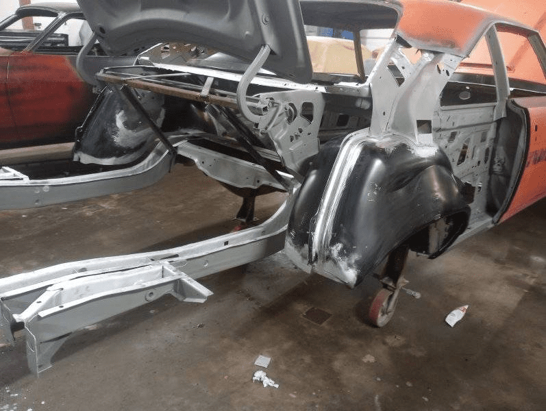

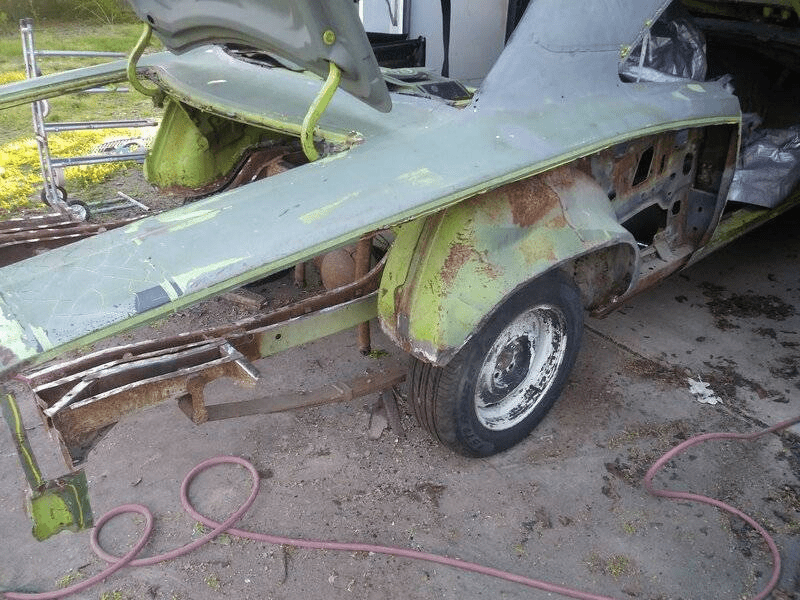

so...... this pushes the centering pin rearward one inch? what happens at the back end of the spring? is the main leaf different, or does the shackle absorb the extra inch?
I think they just changed the rear shackle mounting point.
I don't think so, that would be a difference in the unibody
but honestly, I've never noticed or thought to look.....
edit: they look the same in these pics
That 1" would not affect the roof.
They do look the same in the pics. When you order new springs they are the same for both Dodge and Plymouth.
