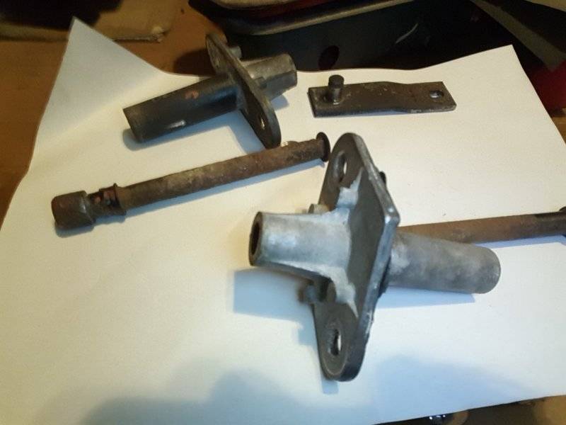

Since the wipers were not working, i removed the whole stuff and looked what's going on there, driver side was frozen and passenger side's totally worn out, got them apart and thought im not going to mess around with the pivots and replace them, but can't find any new one, aren't they made anymore or maybe i'm just to stupid to find some?
Before you reinstall the pivots, drill and tap them for grease zerks.
