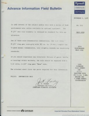

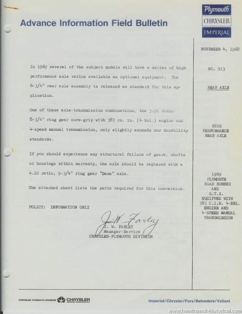

Sorry it was 1969. However, maybe warranty?
WOW!! That is a great piece of paper to have! I have no idea how it ended up with a Dana, would be cool to know though. At this point I am just going to say I don't know why it has a Dana (you know, the truth!). But I sure am glad it is there!
Thank you for your help everybody….
