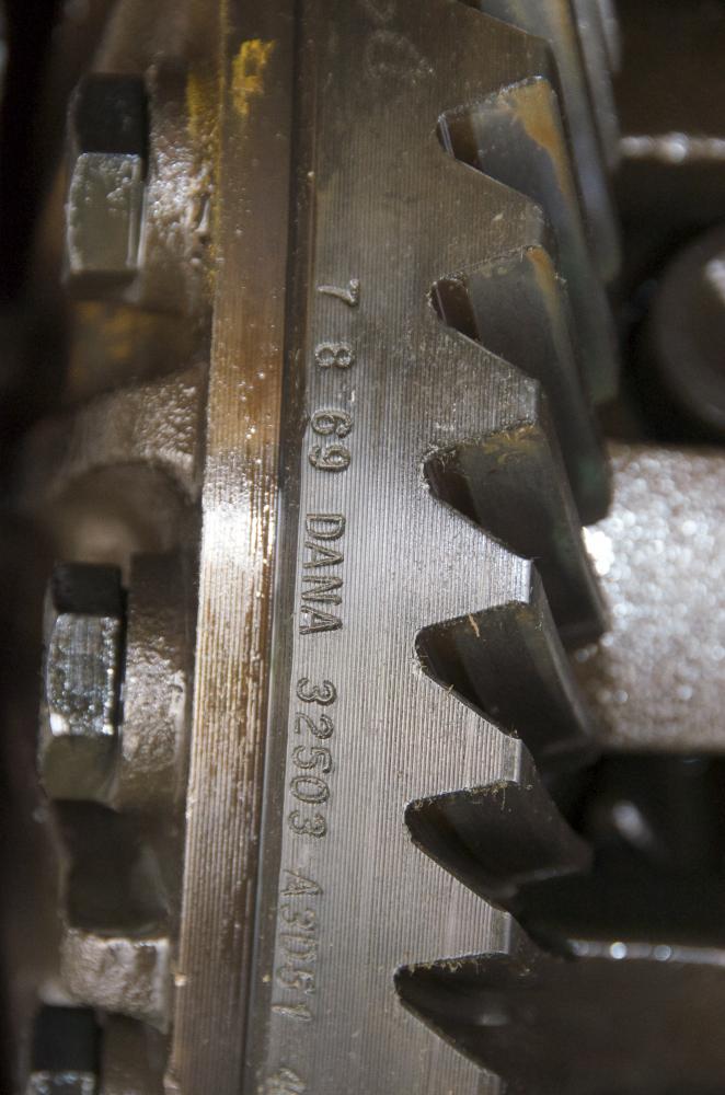

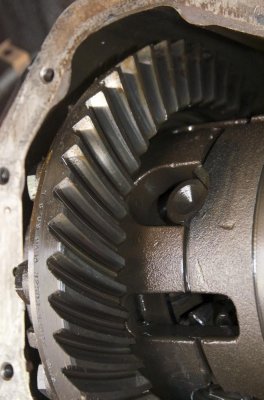

So I pulled diff cover today to clean out the nastiness of decades of non-use, and find a rear end in remarkably good condition. Pulled bearing caps, everything looked nearly new. Gear wear pattern is there, but really not what I expected for a hot rodded car. Heck, not even a station wagon rear from 1970 should look this good. Ring gear, pinion gear…just very good shape. Backlash right in middle of specs. So obviously a recent rebuild prior to being abandoned, right?
But then there are the date codes on the carrier and ring gear. Ring gear date - 7/8/69 carrier 10/23/69. WTF? This owners brother told me they street raced it every weekend. Never broke rear, trans, or the engine. Trans and engine are #matching to VIN. Is there a VIN location on a Dana? I sanded axle tubes by hand, and found some number stamps. Going to take some CSI work to get them legible for my old eyes. Any experts out there that can untwist my confusion?

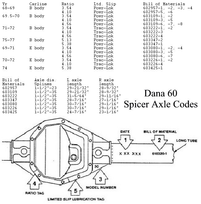

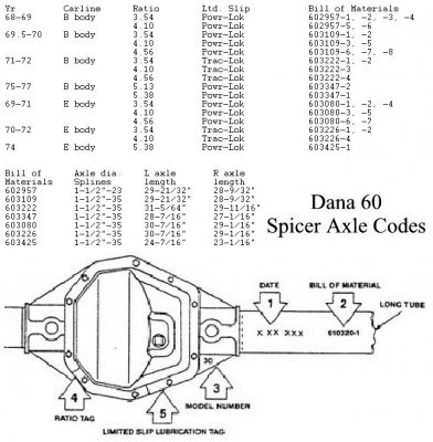

Plumcrazy, see if this info helps any with the numbers you found. The VIN is not stamped on the axle.

Oh man, 69Coronet, this is EXACTLY what I was looking for! Thank you so much! I can read the date on the right axle, and it is late 1969, The model (60), lube tag, and ratio tag(3.54) all there, and match. The BOM is definitely 603109 but I cannot make out the dash number. Haven't pulled axles all the way out, but my tape measure seems to match real close to the axle lengths.
So now what? I truly believe that a customer in a small town, Grand Junction, CO, might be able to lean on a sales manager a bit, and I am sure they would happily swap axles for the new owner if he had the cash. But the owners brother swears they took it right after it was unloaded off truck. Sure wish mice hadn't eaten build sheet. And that there was a reliable person to that made a living documenting these things for us.
