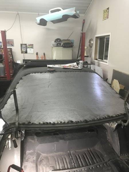

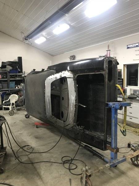

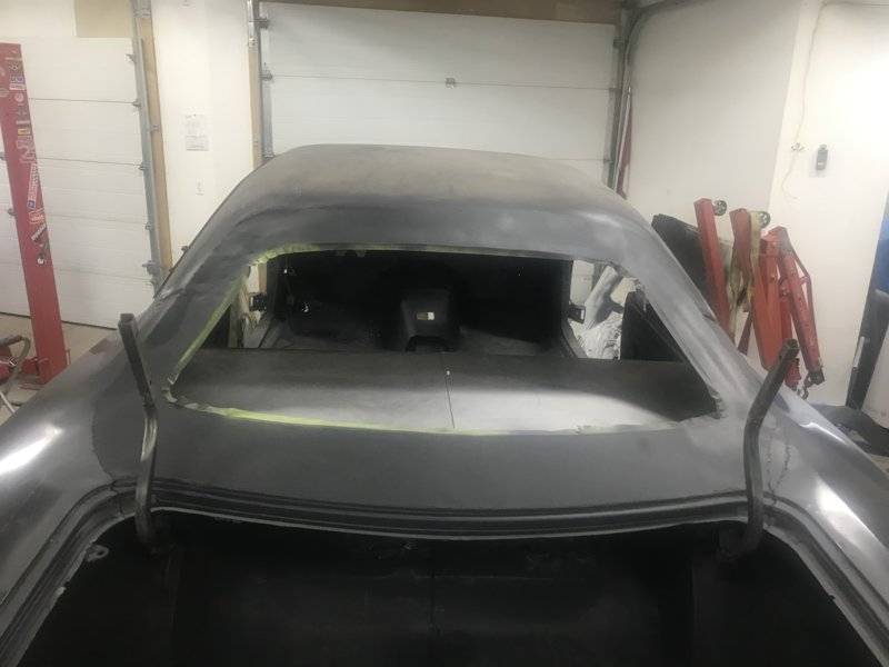

Okay the window plug is now fitted in !!

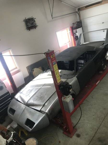

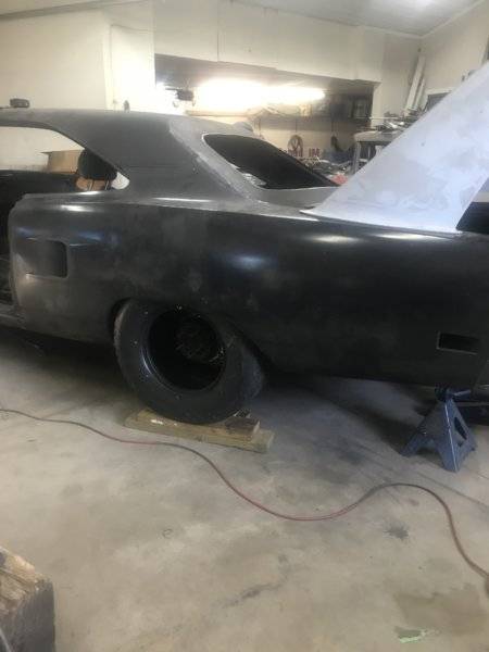

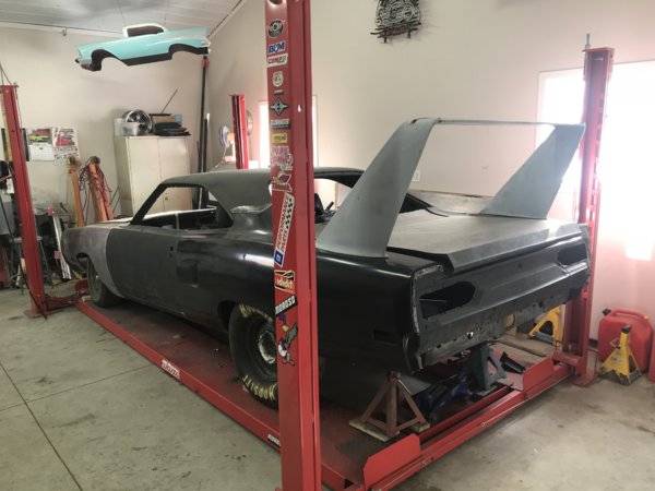

The rear wing has been installed!!

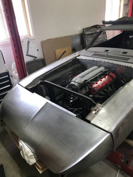

Every once in a while for motivation you just have to put it all together ! The hood still needs to be cut

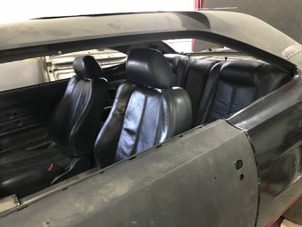

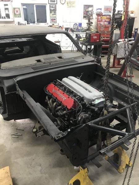

Trying out some seat options, next up is Viper fuel tank mounted in the trunk !

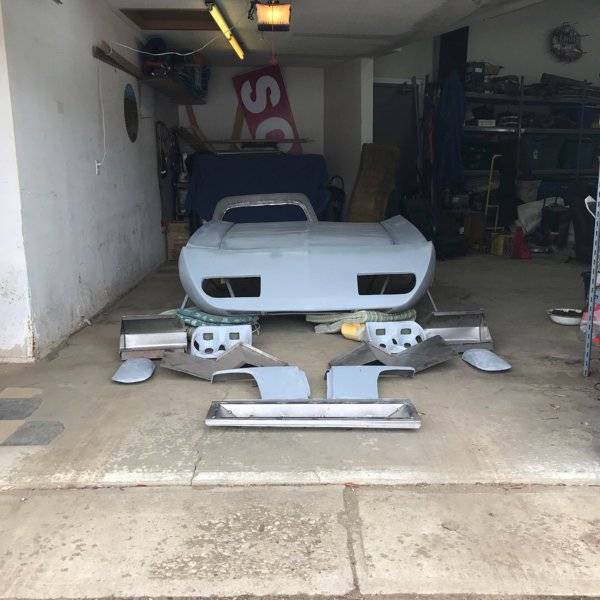

Picked up the new new steel nose only 5 hours away and it is going to fit beautifully .

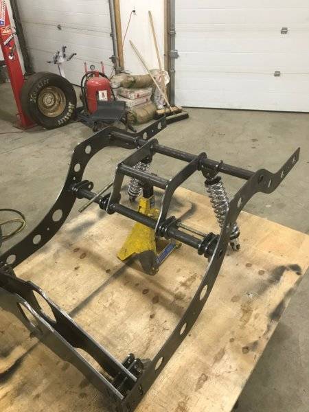

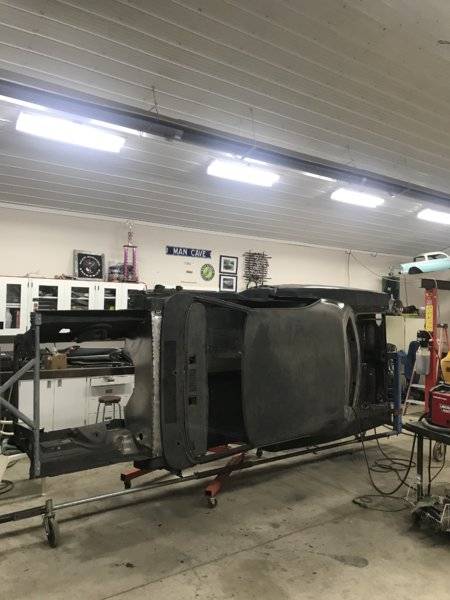

Took a break from the rear window plug , to work on the 4 link and custom subframe. All tacked for tig work!

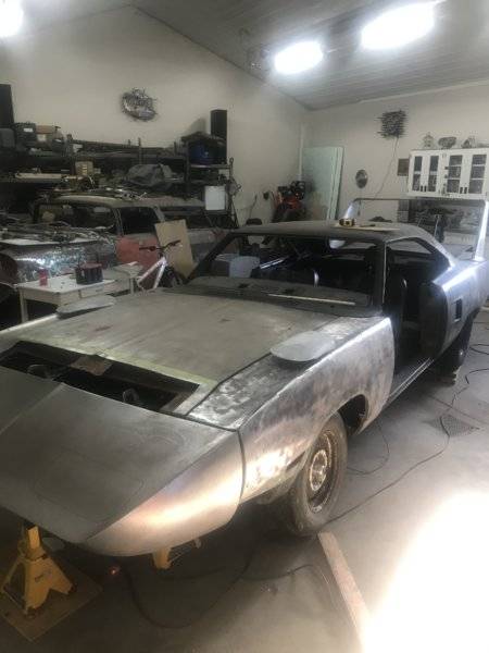

Wow, can’t believe it’s been 15 months since my last post . Since then I started a new business bought and sold a few cars and here is where the Superbird Is at today ?
Now installed :

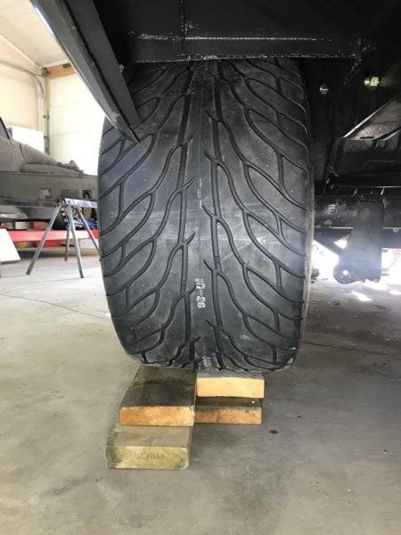

New wider wheel tubs
New frame reinforcement’s
New brake cooling system making body side vents open
New smoothed firewall
New tranny hump to accomodate Tremec 6 speed
New window plug
New rear package tray
New fuel cell compartment in trunk
New custom four link system for the Dana 60
New nose mounting frame
Customized K member and Tranny mount

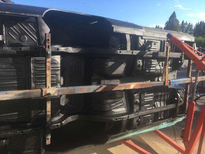

Underside all sanded, primed and under coated
