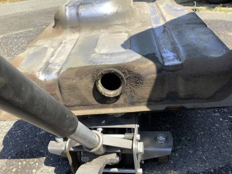

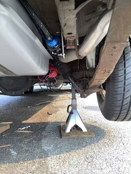

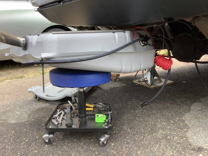

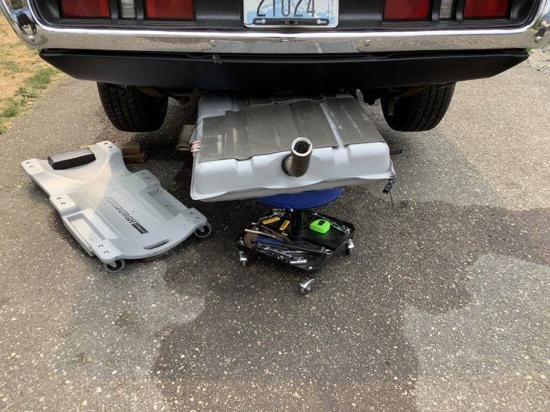

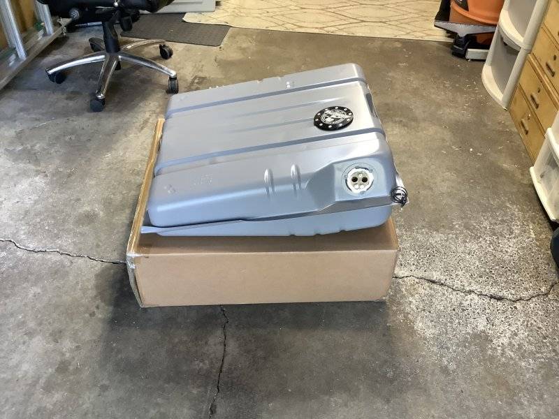

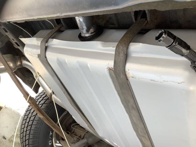

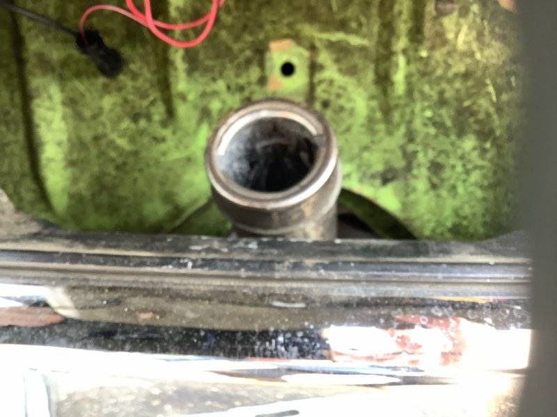

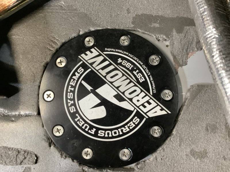

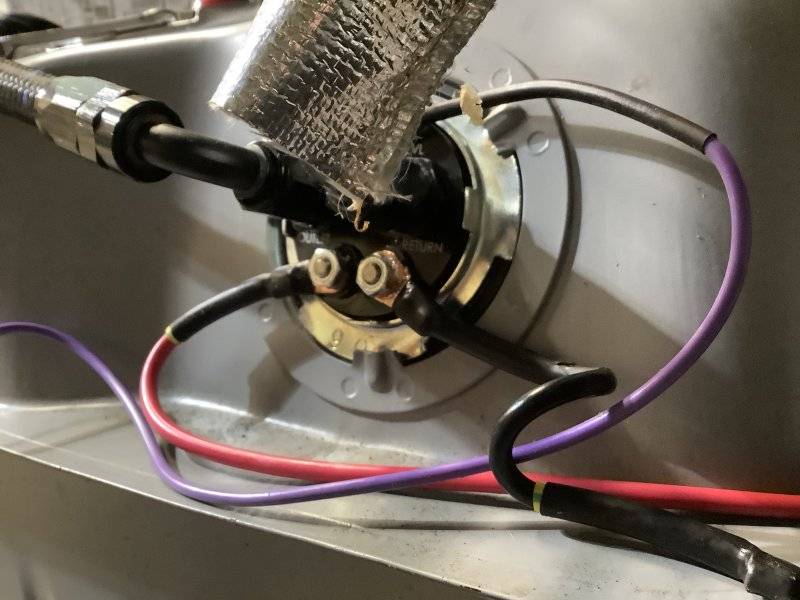

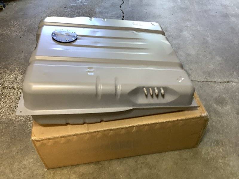

The tanks are the same dimensions but the tank straps are different. I put an Aeromotive efi tank in my 74 that had the hump and it was a decent fit. Filler neck is the same but getting a good fitting gasket is important. I reused the original straps.
