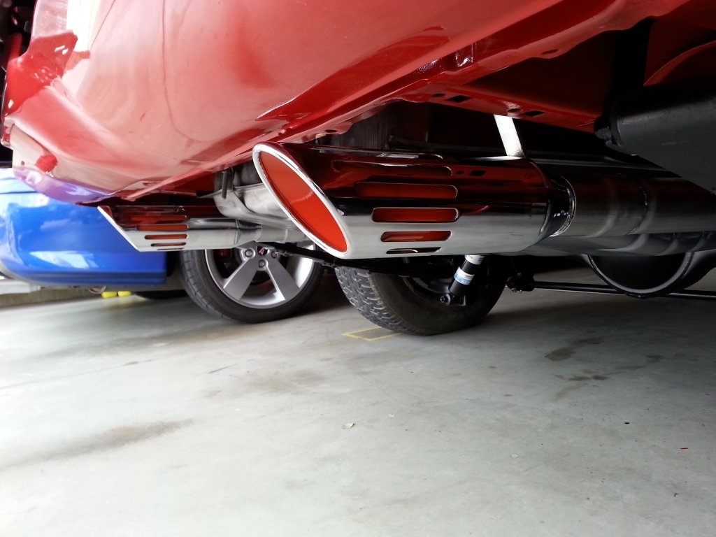

I didn't realize that I had them extended too far until I saw the pic of the red car posted above, but I agree, they don't look too bad in this position.

I think they look good, keep in mind the tuck of the rear panel on the 71/72 is different than 73/74, so position may vary, plus I am sure not all the cars had the exact exhaust tip placement when built.

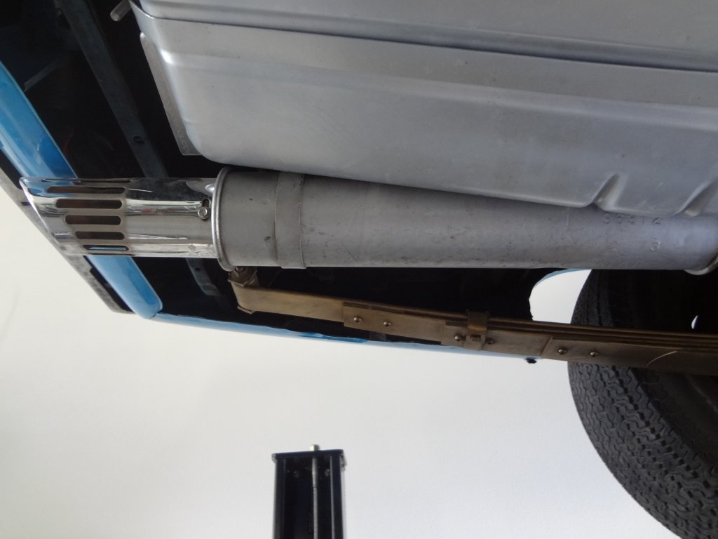

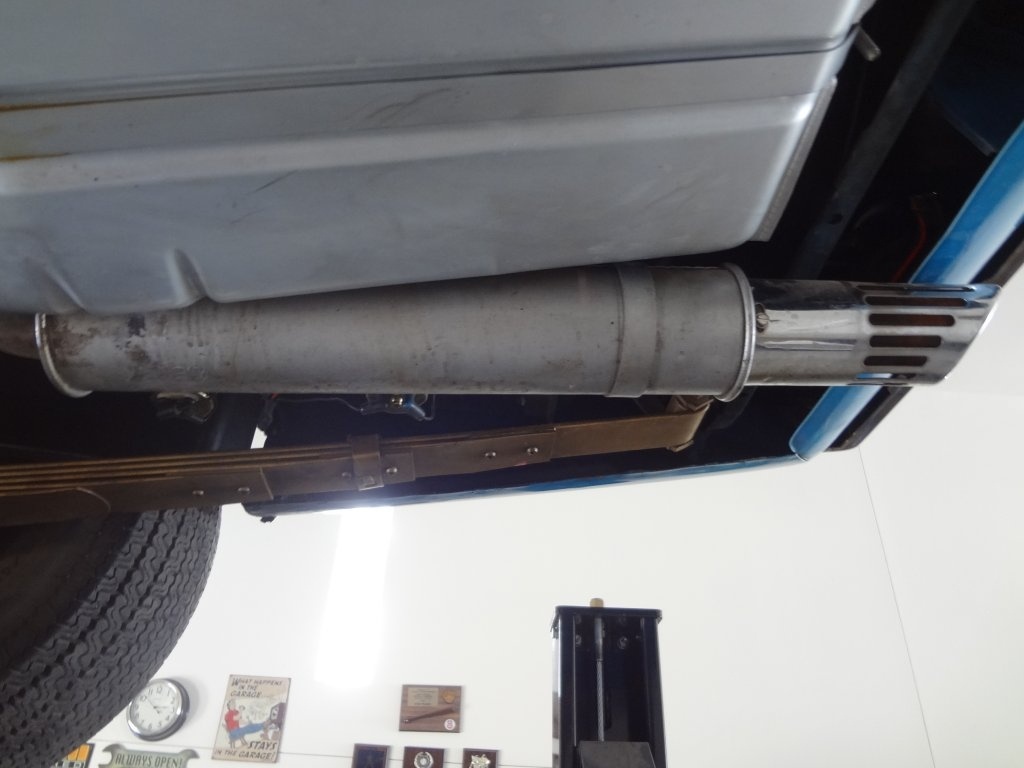

Here is a couple of pix of my original exhaust tips on my 73 RR

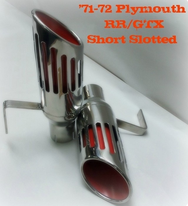

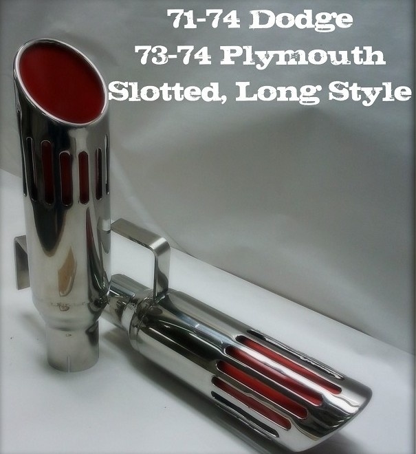

The info you have found looks to be correct as far as I can tell. I'd go the extra few bucks and purchase the rear valance too, they look great with the cutouts.
I am not 100 sure about this BUT I don't believe 73-4 B bodys came with resonators. I KNOW my 73 did not. Original exhaust which is also what I ordered according to Waldron Exhaust in Michigan was 2.25, 5 pipes, left side being 3 piece, right 2.
I saved these pics from a while ago but it's what I went by.

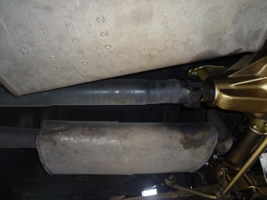

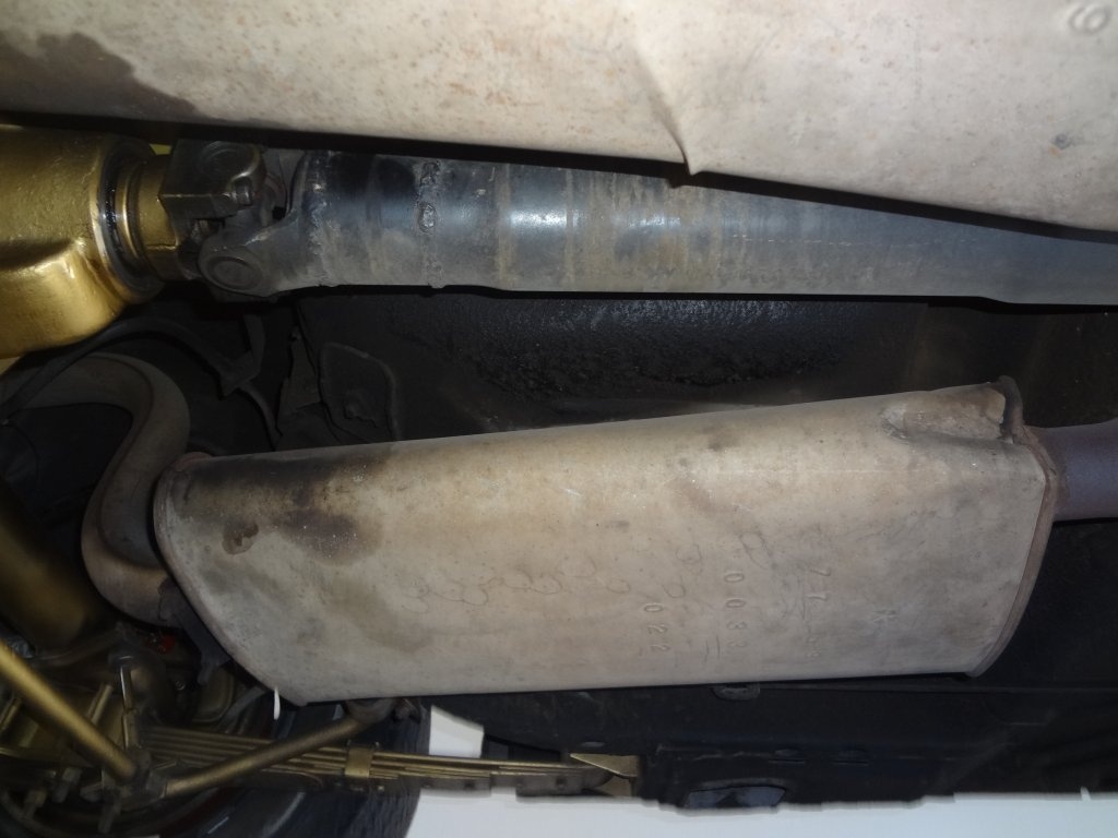

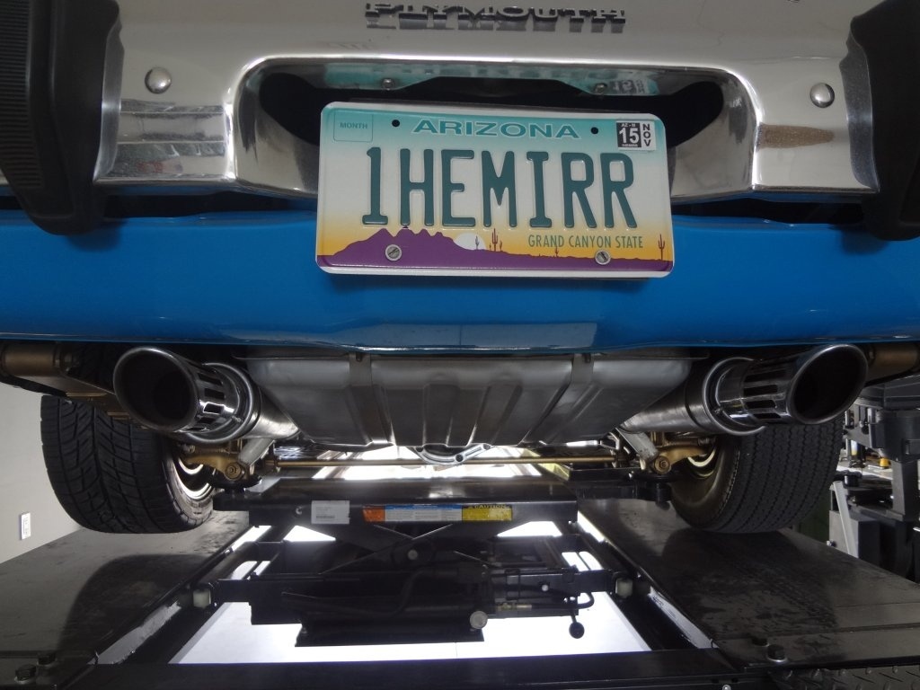

I know 73 Roadrunner GTX's had both mufflers and resonators with machine gun exhaust tips because my car still has the original exhaust from the headers back. I'm the second owner of this car and have had it since 1976. I guess I have no complaints since this exhaust is 44 years old.
But it is time to replace the mufflers since they are in bad shape. The resonators are still very solid.

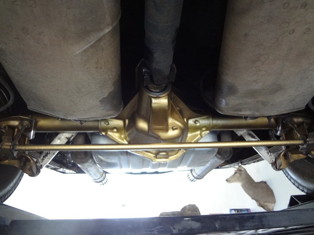

Is that entire axle coated in cosmoline?
That looks awfully fresh for 45 years old.
Never seen that before, either.

When I installed the Dana 60 back in 1980 I painted it with Gold Wheel paint and Clear coated it. I wanted the Cadium Plate look.
Well, that's very interesting, must be a big block or GTX thing then, as this is the first one I have ever seen with the resonators and tips. I got my car in '83, third owner. I do have to ask, if its the original exhaust, how is that working with a transplanted Hemi? It would seem that you would want better flowing exhaust with that setup.

As you can see the mufflers are in bad shape now. That is my next project for this car is a new exhaust from the Headers back.
Yes, I agree the stock Hi-po exhaust probably is restrictive for the Hemi. And worse now that the mufflers are worn out.
I hope I can find a pair of Hemi repro mufflers that would give me great flow and the appearance of original equipment.
