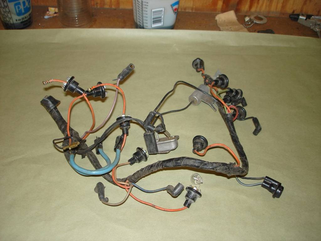

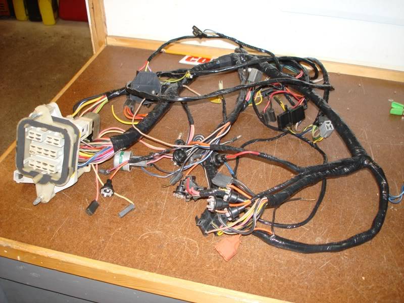

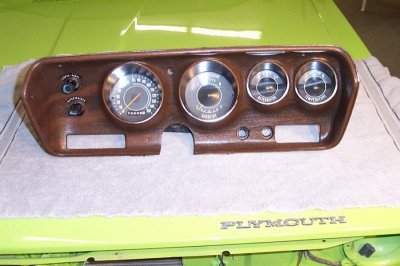

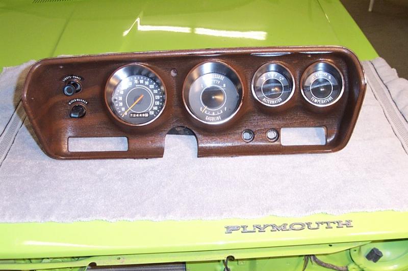

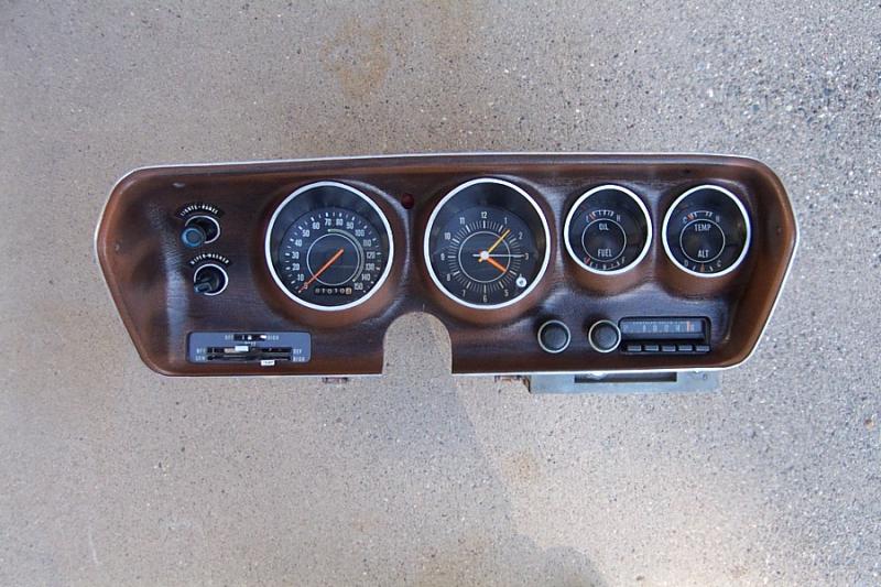

72RoadrunnerGTX pretty much summed it up for you. Glad he likes to type more than me. Here are the two clusters.
Standard Rallye
Clock or tach option cluster.

you can also get a CLUSTER PIGTAIL LOL ( like the first pic posted by 72RoadrunnerGTX ) and splice it on your standard cluster multipin conector, like he said. Sometimes when you buy a cluster it gets still this section of harness attached.

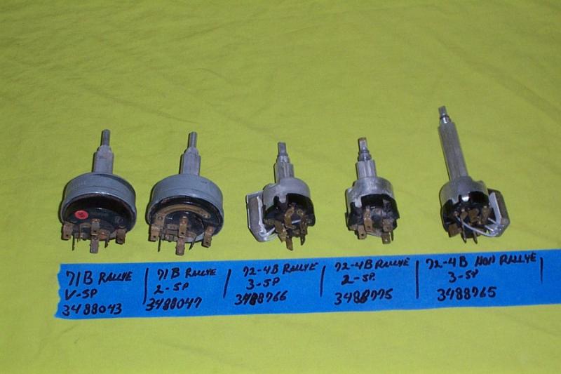

Sorry Nacho friend but 71 has its own wiper switch. 72/4 the switch has an index knotch so the switch only goes in one way. 71 does not. So a 71 switch will fit 72/4 cluster but the 72/4 switch will not fit the 71 cluster without knotching the hole. This is also for 72 build before 9/2/71.
Also all non-Rallye wiper switches are alot longer than the Rallye switch.
As many times as these things and related with the Rally clusters come up, we could use this as a sticky.. ?

71 and 72 built to 9/1/71 had either 2-spd and Ver-spd. Cars built after 9/1/71 had either 2-spd or 3-spd. 3-spd replaced the Ver-spd on 9/2/71
