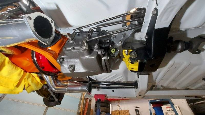

Here's a picture from the underside showing the collectors in place.

Thats great info thankyou rear of engine plate? Just the rear part of the engine where the Trans bell housing would bolt to (I was just tring to think of a reference point?)

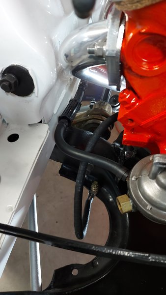

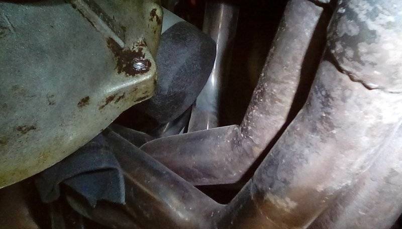

I took a couple of close up photos last night.
It's pretty close.
When it comes time to fire up the engine I'll put a new smaller one on.

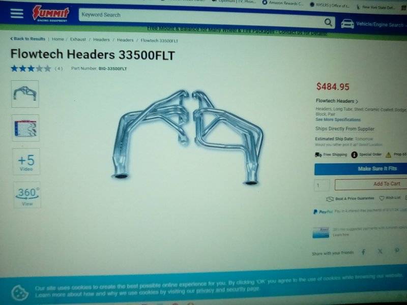

So, I looked at the small block Flowtech headers on Summit.
They sure look to me like they go below the steering.
Can anyone confirm or deny?

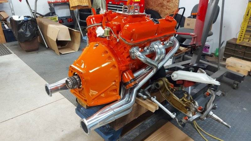

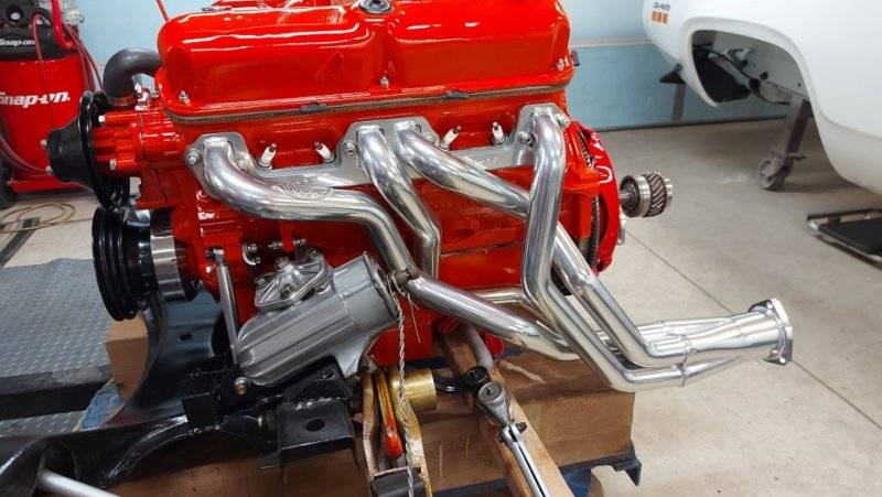

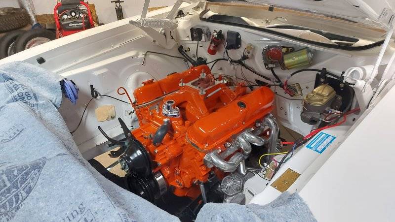

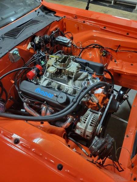

like I said in my previous post, I purchased my headers at a swap meet and from all of the research I have done I am 95% sure they are Flowtech headers. They fit great with no clearance isss, thick straight flanges and no leaks with remflex gaskets. I have had the same headers on both my LA 360 and my current Magnum 5.9 in my 72 Satty with AC. My car is currently on a lift so i dont have great pictures but i have never bottomed out. Currently using a straight full sized oil filter. FWIW the guy purchased them from said they would not fit in his A body and did some hammer work on the primary pipes but they would not have been necessary in my case.
So they are below the steering link, then?
Your link pic looks like they're not, but the pic of your car looks like they are.
The link pic also doesn't look like the same design.
Shows driver's side 4 tubes in a square config.
Pic on car shows three on the bottom.
