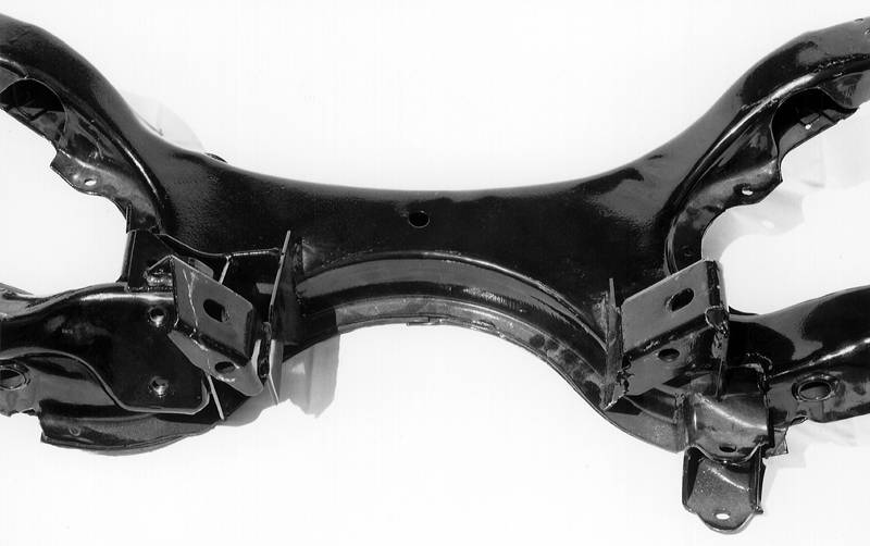

Here's a pic off ebay
I cant see the underside of the mount. Are you working on a '71?? On biscuit mounts, they can slide a bit left and right to level the motor in the oblong holes in the K-frame. Yours might be a little different.
Picture courtesy of Schumacher Creative Services.... maybe a trip over there to look at the various K-frames in the tech section may help you.
Yup its a 71
That looks like my kframe
So I'd at with the bolt attached to the kframe itself and not the engine block?
Yes

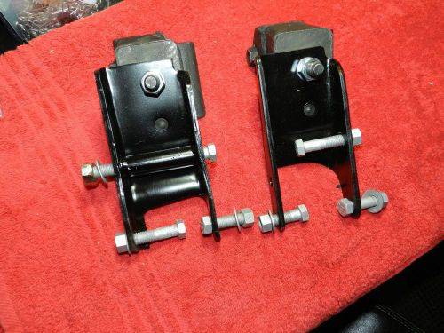

Start by loosening the two insulator bolts (One on each side of block , attaches motor mount to K Frame)
http://www.megapartsusa.com/proddetail.asp?prod=110-C8088
Much easier to access the bolts obviously from underneath , very easy to get at
Bolt will go through motor mount , then oblong hole in K Frame , then nut itself that is welded on motor mount
Ah got it now thanks
Ya I see the hole which has some room
