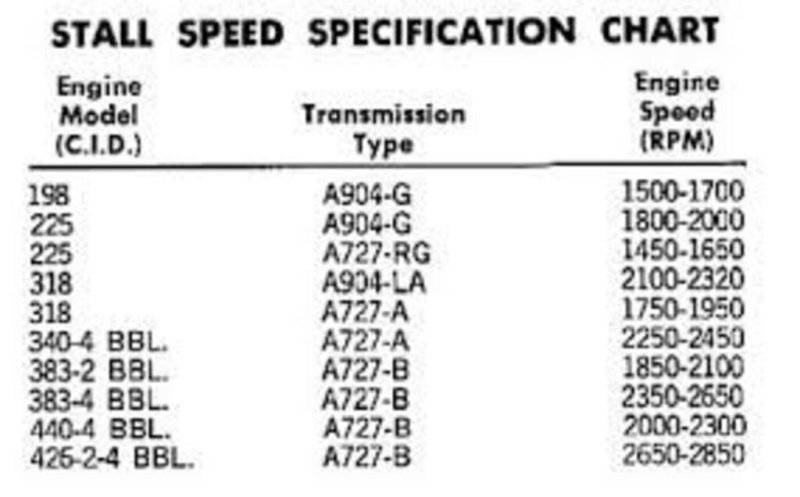

A simple Google search will reveal when Chrysler started using lockup TC's.
Further digging will reveal the following table on stall speeds, but use it as a guide at this point. Refer to your FSM for other info.

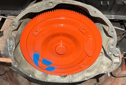

Trying to get the pictures to load. I'm an excellent product designer and petroleum geologist but at 68 never a mechanic except basic stuff.

Please post some pics... GM is 3 bolts, mopar 4.. someone above mentioned the offset bolt but didn't explain it well..
Mopar TC's bolts aren't symmetrical so they only line up in one position (which is awesome if you don't mark it before putting it in) SOO... you end up putting a bolt in 1 hole.. spin the motor over and watch to see if they all line up now.. Nope? take that bolt out.. move 1 hole and try again... til you get the right one.
It sounds stupid but it's so people can't put a balanced TC on in the wrong position (i assume)
If you ever have it out and the flexplate out line it up on the tc and mark it like this.. no more guessing..
