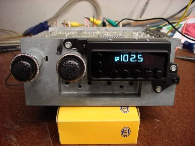

71 Charger....moving on to radio
front is 4x10 ( available around BUT speaker basket could be diff )
rear left is 5x8 ( availabe around BUT screws locations are diff BTDT, got a NOS one long time ago just because that )
rear right is 9x6 ( any commercial brand will fit correctly there )
Ended up going with the dual front speaker arrangement. Now I am trying to see if anyone is aware of a "matching" pair of speakers that will fit the 2 different speaker openings in the rear package tray.

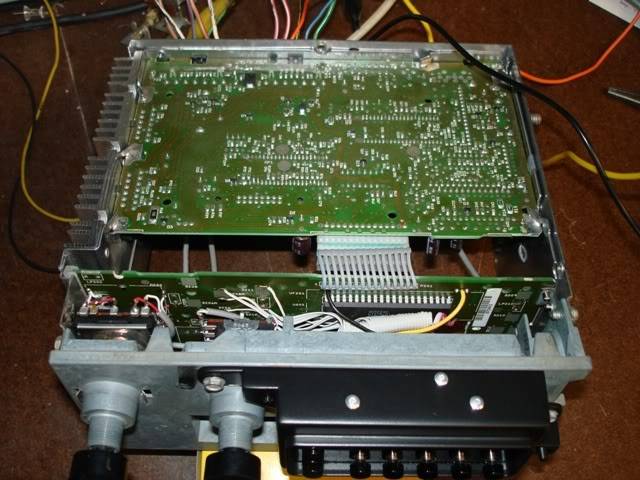

i litterly hate seeing the rallye dashes cut for stereo's .I have taken a am radio and took all the guts out of it .I am in the process of either mounting a cd changer and put the controller in the radio .With all my Deep purple music and Skynrd as well i do not want to hack a dash or a glove box .whatabout mounting the faceplate in the sunvisor run the wires down the Apillar and put the deck up under the dash tucked away neatly ...DON'T CUT THAT DASH......
