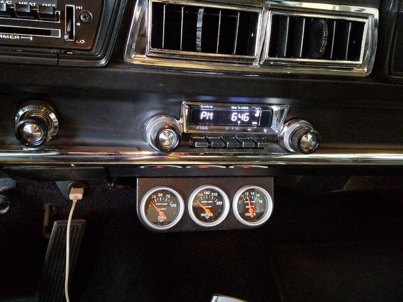

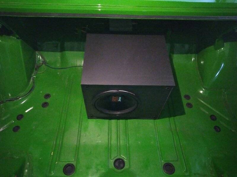

I went with the Retrosound Redondo in my '67 Belvedere. I added two 6x9's in the back, a dual cone unit in the factory dash location, (it is actually 2 speakers in one frame), and a subwoofer under the seat. I love the Retrosound for a few reasons. It takes the factory knobs and bezel. There are a few different station preset button options. The one that I picked looks pretty close to the originals. Other than the digital readout, it looks pretty much stock. There are 2 USB jacks. I got a mounting bracket for one of them, so I can charge my phone. The sound is excellent. And I can stream music through the Spotify App on my phone.

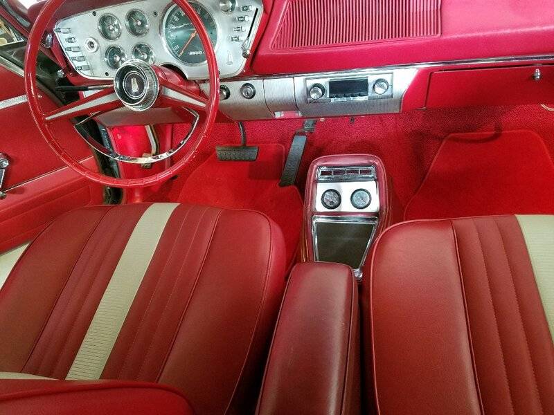

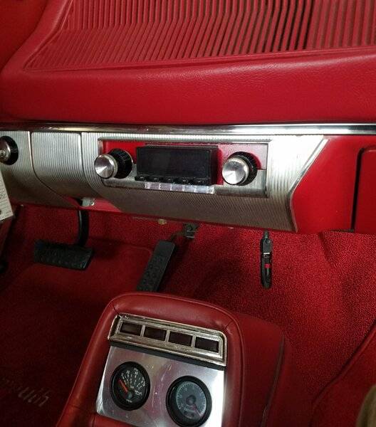

That’s one of the things that appealed to me with the retro (using the original knobs) and no cutting up the dash. I had to cut the bezel though (no issue since I have 3 of them) and made a reversible aluminum face plate to set behind the bezel. It has a flash drive port for music rather than use the phone, just my preference, and the unit has a power antenna lead buying one on ebay. Next project is adding more speakers…being a vert anything behind the front seat doesn’t work without more electronics so hunting for a box to mount some mini-speakers beneath the radio.
