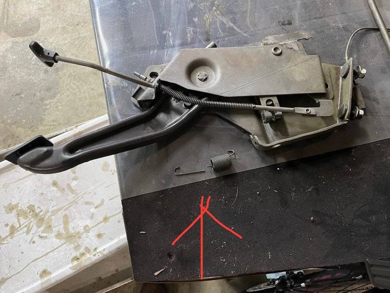

I was able to get back to this problem of the broken spring, I decided to disassemble the parking brake and see what I needed. After doing so, I cannot figure out where this spring would connect, anyone out there have a parking brake assembly available that they can look at or take a picture of?
Not a great reference photo but hope it helps. I guess I do not have one out of the car.chargeremerg.jpg
