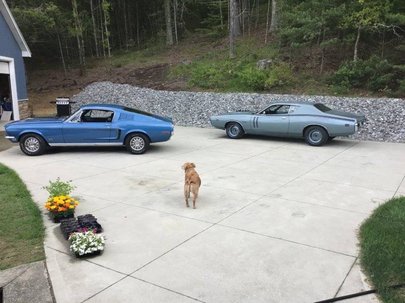

No problems with that combination. Ran the same on my 72.

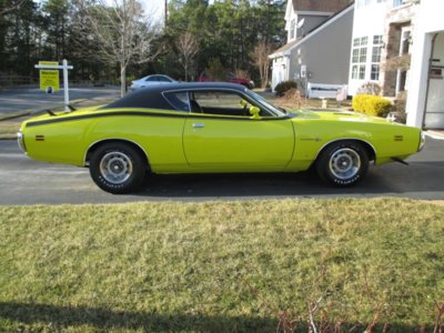

Aw the will 295 fit. It's been asked many times before and yes they will fit with the right backspacing. It will be a very tight squeeze tho.
I have 15x7 with G60-15 front and L60-15 rear. The 255 will fit the front on your car but surely rub the inner frame rail at full turning lock.

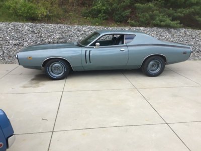

Well I did the up grade. 255/60/15 up front and 275/60/15 in back. Haven’t washed the WL yet or installed the caps. But I like it much better already!
