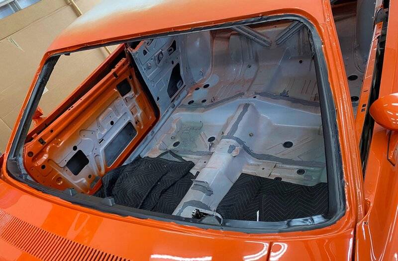

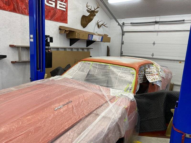

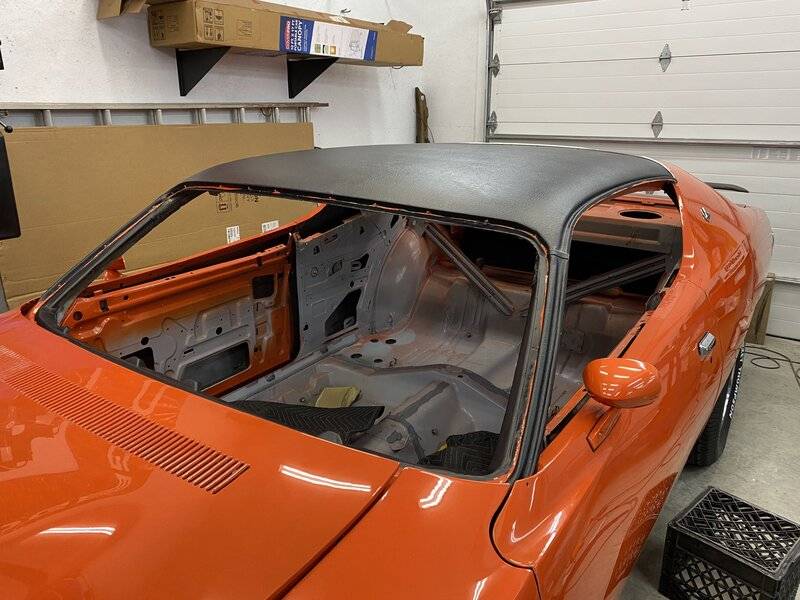

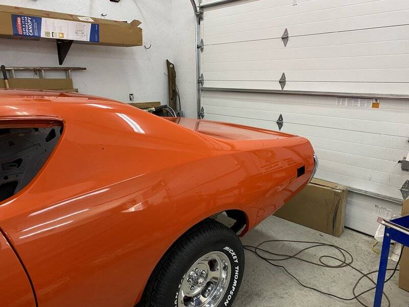

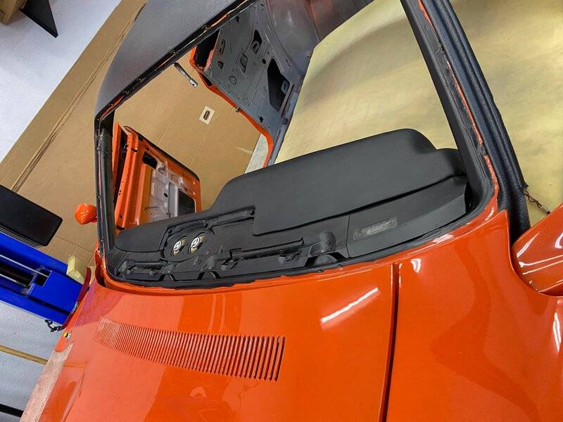

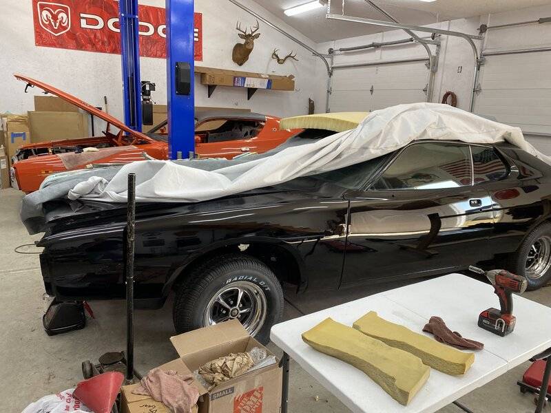

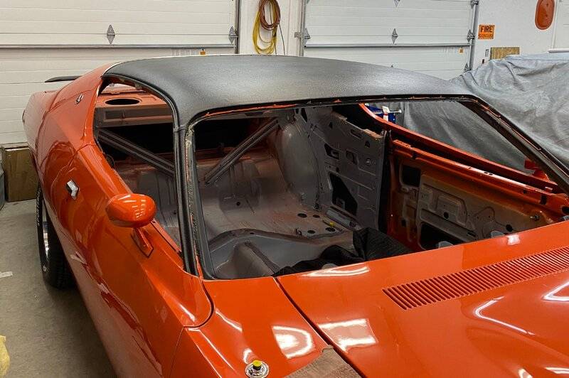

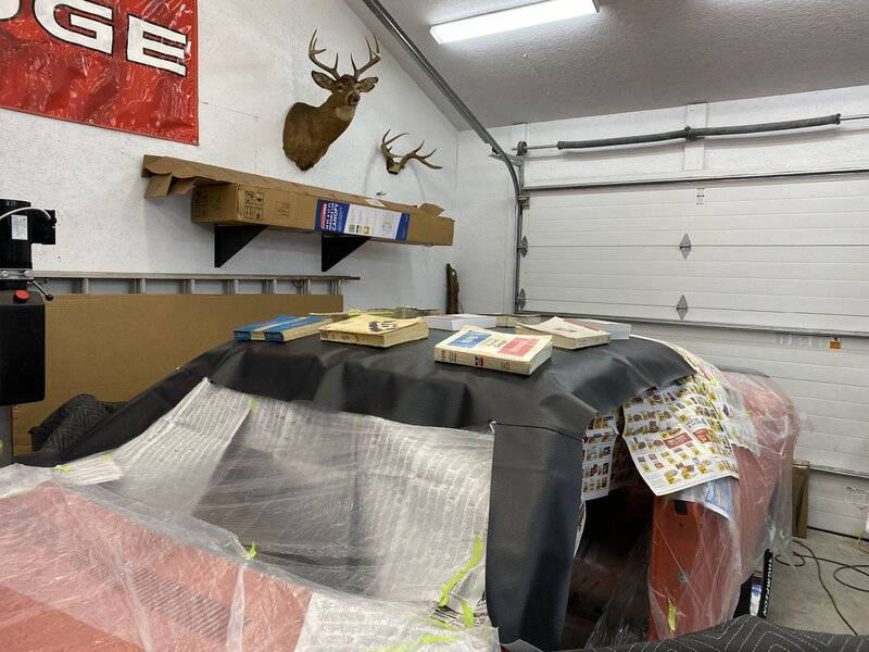

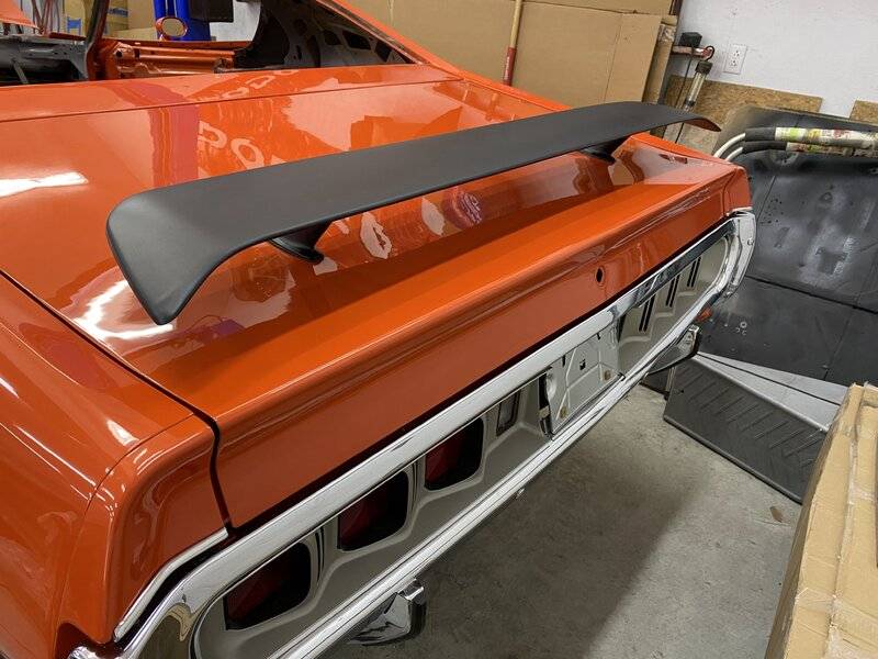

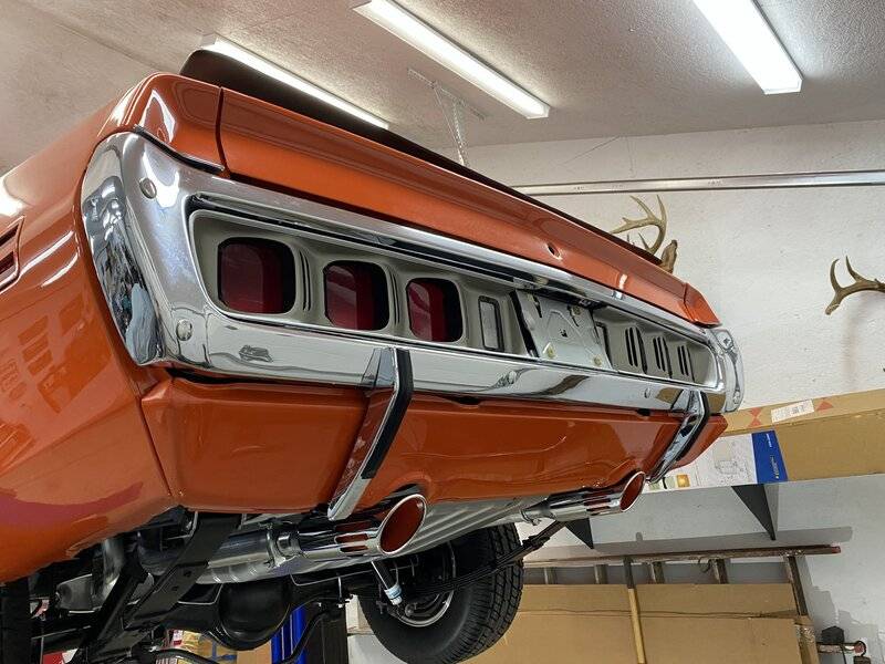

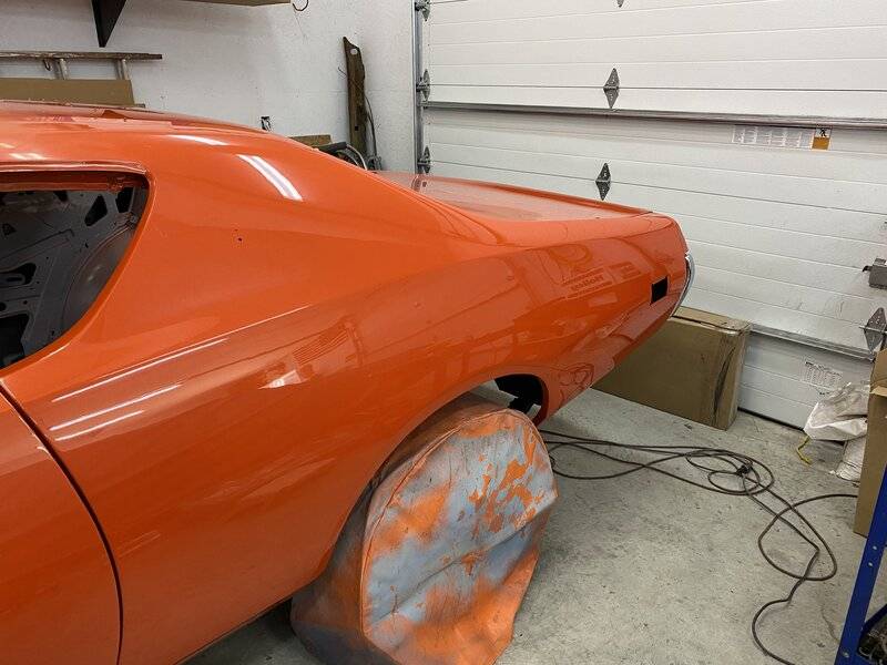

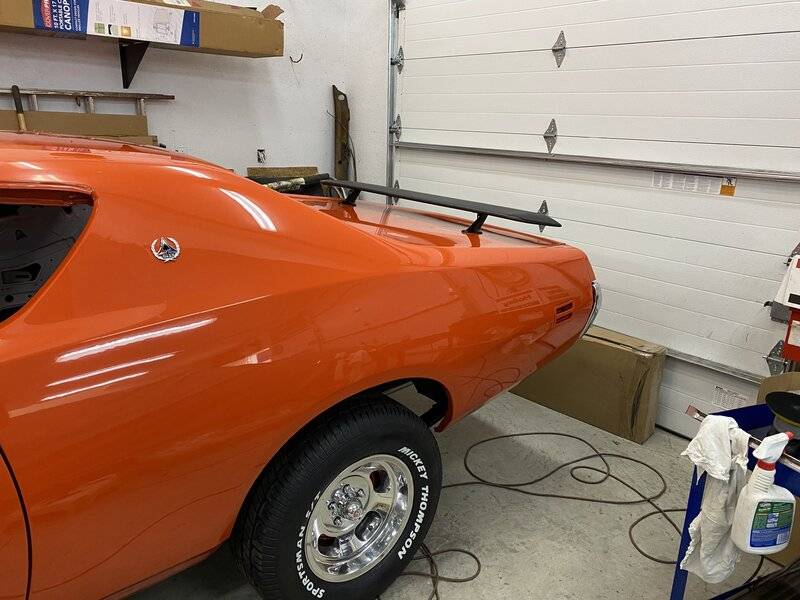

Looks great. I like the gull wing. I think they really look great on about every 71 or 72 car mopar made. Jmho.Did the final cut and buff on the back half and sealed it. SE emblems on so I can get the head liner in. Rear markers and Gull wing for all you wing haters. LOL
View attachment 1187471 View attachment 1187472 View attachment 1187473 View attachment 1187474 View attachment 1187475
Are you doing front spoiler ?
Wheel Opening Moldings ?
Beautiful

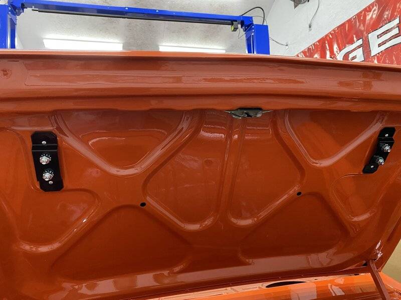

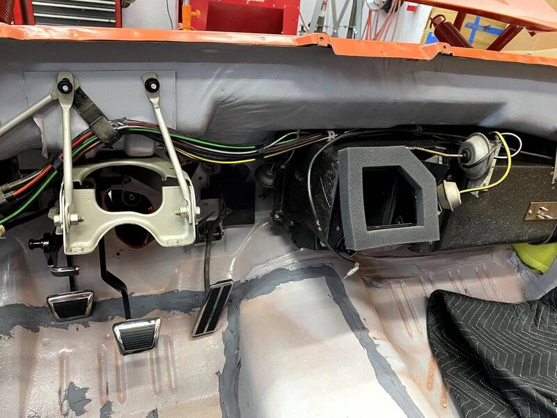

A question on your clutch pedal. Are you using the over center spring?

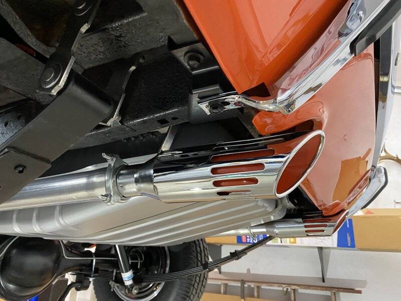

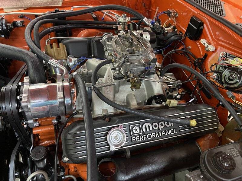

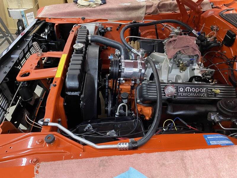

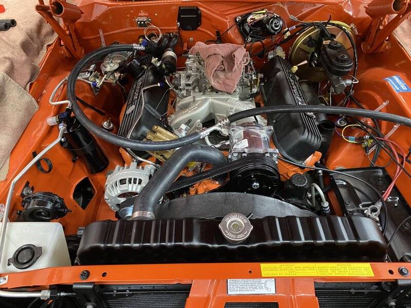

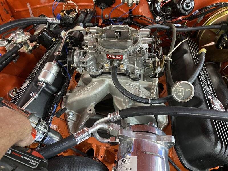

Wow! Beautiful!Yesterday I finished the exhaust. The original tailpipes I got from Dons did not fit right. He went out of his way to fab me up a new set and shipped them to me on his dime just to make sure they are right.

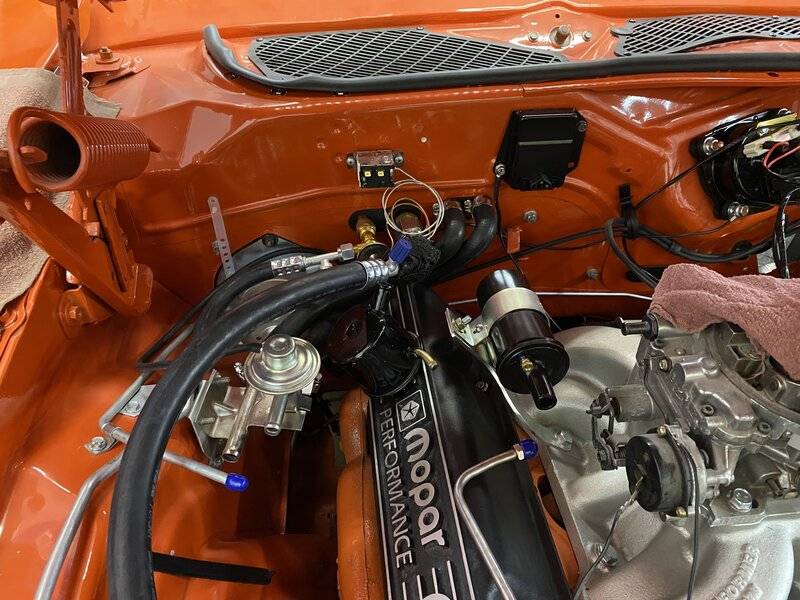

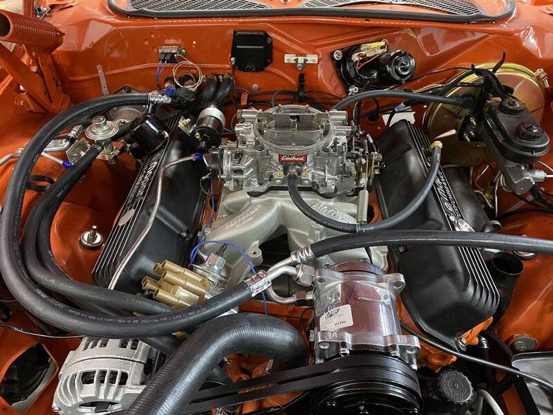

Today I went through the carburetor. It's a 800 CFM AVS that was on my 73 SE when I bought it. Somehow the owner thought dropping this on a low compression 400 would run good. It was way rich. The floats were way off and I dropped the main jets to .410 and changed the metering rod springs to 7" ones. We will see how it fires up.
