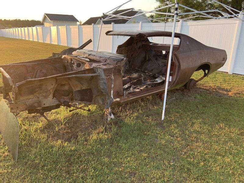

Yeah I want someone to be able to use the rest of it, nice frame, rockers, and 8-3/4 drum to drum. Heck the left quarter is usable. Even has a title...

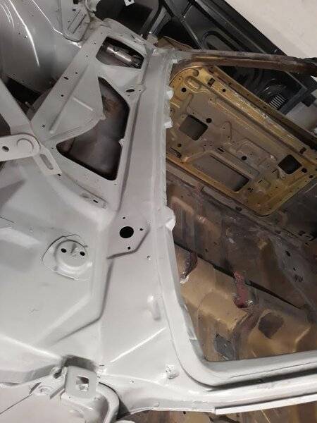

Engine compartment striped to bare metal and epoxy primed.
I could use the entire drivers side inner and outer rocker panel for the 71 Charger R/T. If I was closer,that would be on my trailer,and we would be drinking some beers for sure.

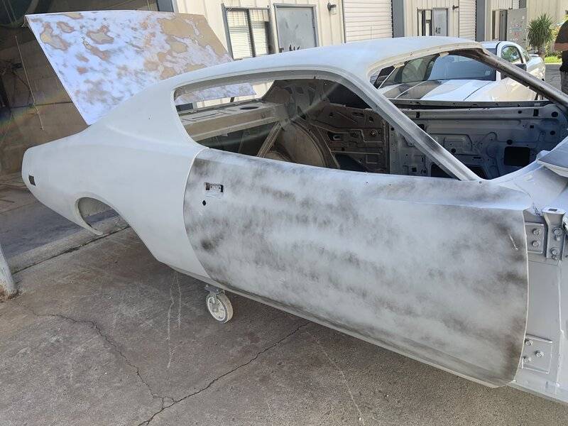

She is getting straight. Lots of blocking now.

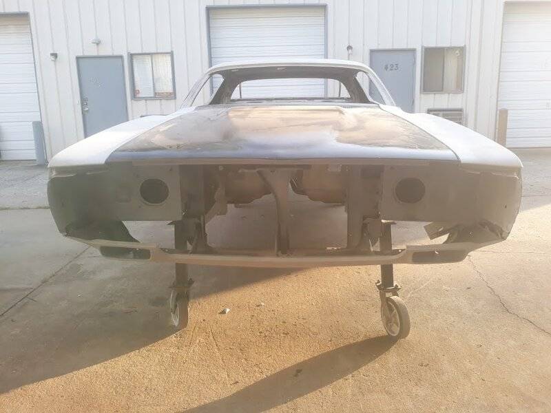

@Crackedback made them for me years ago.

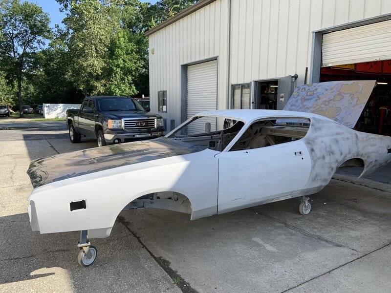

How tall are your dollies with the wheels, and do the front or back have a cross bar, and would you have them higher or lower than yours, given the choice?
Making my own. Nice progress on your project, I’m sure it’s going to come out amazing!
They are about 18" Easy enough to add a cross bar, just an L bar bolted to one dolly bolt on each side. Another foot would be nice for working underneath. Now that I have a lift that won't be a problem.

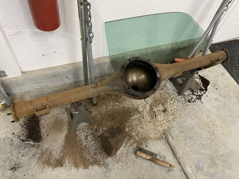

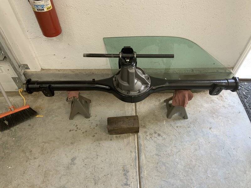

While my body guy wears his arms out blocking the car I started working on the mechanical stuff. Stripped the rear end and started cleaning it up. I had a good 741 3.55 sure grip lying around so in it goes. Axel bearings were in great shape. New lines, wheel cylinders and 7290 yoke fro Dr Diff. I went with 11" x 2 1/2" I had over the stock 10" ones. A piece of 1/2 pipe works great to drop the third member on the case. Hoping the Harbor Fright recall stands don't collapse under the weight!
Frick!! Never thought of using a bar like that to drop in a 3rd member...:D
Some great progress...:thumbsup:

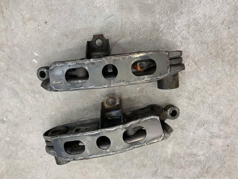

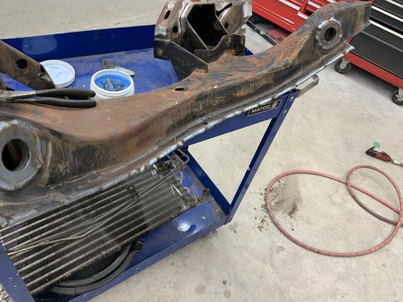

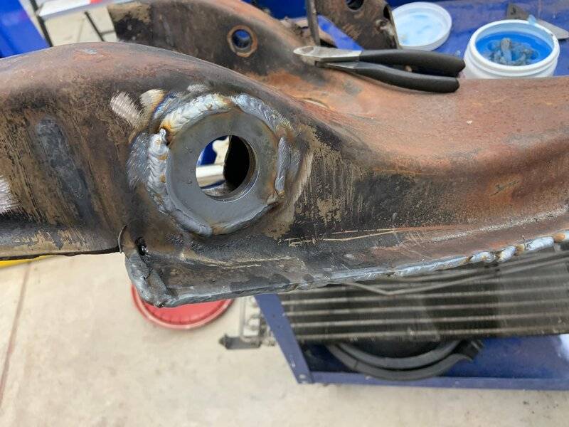

Rainy Veterans day off so I started reinforcing the k-frame and lower control arms.
Will run 1.03 torsion bars, QA1 upper arms, 1-1/4 Hellwig sway bar, and a Firm Feel stage 3 steering box.
