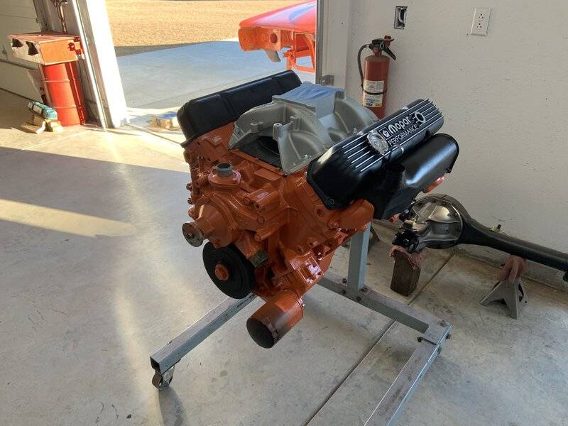

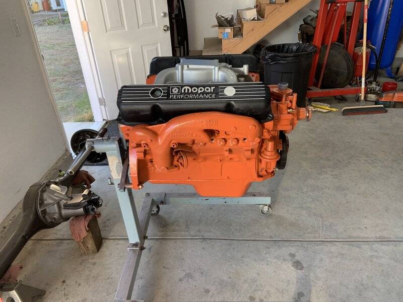

Glad to see the old girl cleaned up and ready to run. Was a good block. Looking good.Engine is done.
74 440 I bought here a couple years ago from @Ghostrider 67

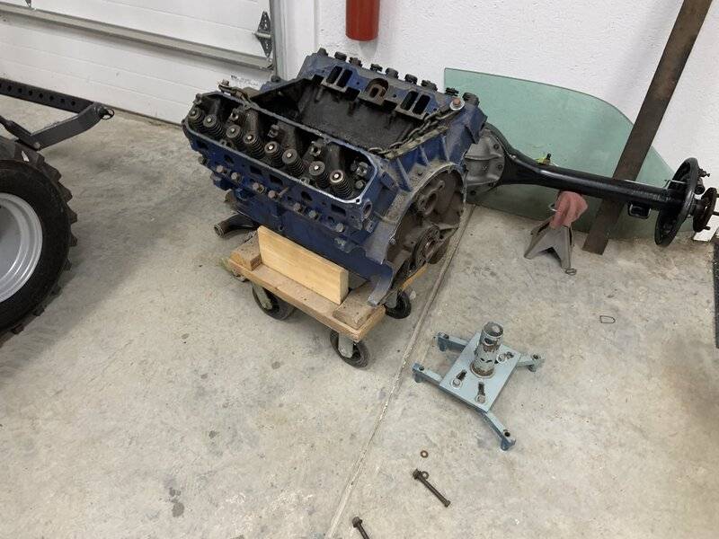

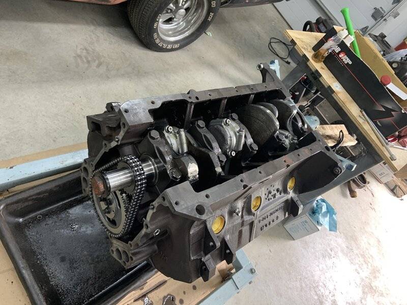

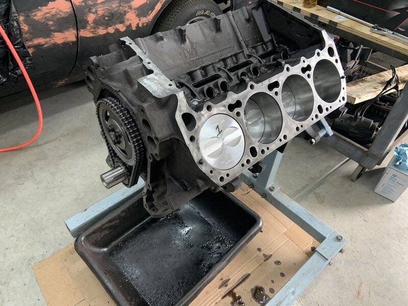

30 over, full block prep. Forged crank. Speed Pro L-2355 pistons, 440 Source I-Beams, fully balanced. I use my original 383 346 heads with a full 3 angle valve job, hardened exhaust seats and new valves. Lunati Voodoo 30702 cam kit. Performer RPM, and will run an 800 AVS for now.
View attachment 1046887 View attachment 1046888 View attachment 1046889 View attachment 1046890 View attachment 1046891
