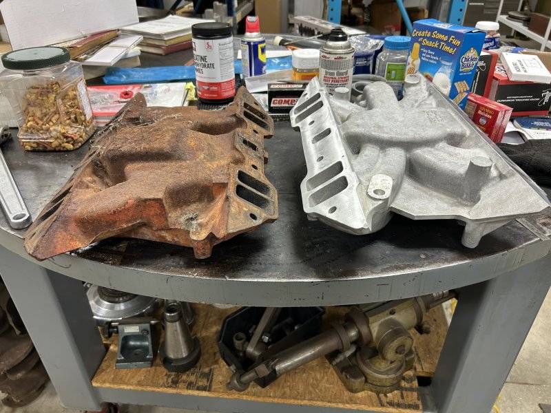

Rebuilding a 400 to stroker, looking for aftermarket intake that is same height as stock because it a air grabber hood. Any info will help. Thanks. 1971 plymouth roadrunner bought new in 1971 and KEEPING.....
You have a little leeway with a b block because you can use a 440 air cleaner base plate. Use carb spacers to get the right height.
The Street Dominator is low...but I don't know if it's air grabber low. But as post 3 stated maybe it will work with a 440 base. Proven in many dyno tests the Street Dominator is the King of intakes that will fit under a hood.
Is a 69 383 Magnum intake manifold the same height as a 1971 400?
The Holley Street Dominator is 13/16" higher than a 69 383 Magnum intake. I call the 440 air grabber base 1" shorter, so it looks to me like you can make it work.
