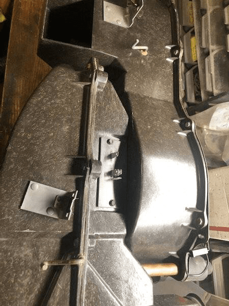

I can answer a few questions if the heater core stayed the same style as for 1973. Replace it. They are not that expensive. It took me two times ordering it from Advance before they got the correct one. IIRC it was less than $40
The hardest part was getting the hanger/clip from the cowl air inlet to release. Just mark all the cables that go to the heater box and take some pics that you can refer back to. It really is not that hard to pull one apart but keep track of which bolt goes where as there are some that are different lengths. These pics might help a little. DMT should have your seal kit that covers 71-74 so your box should look like this.

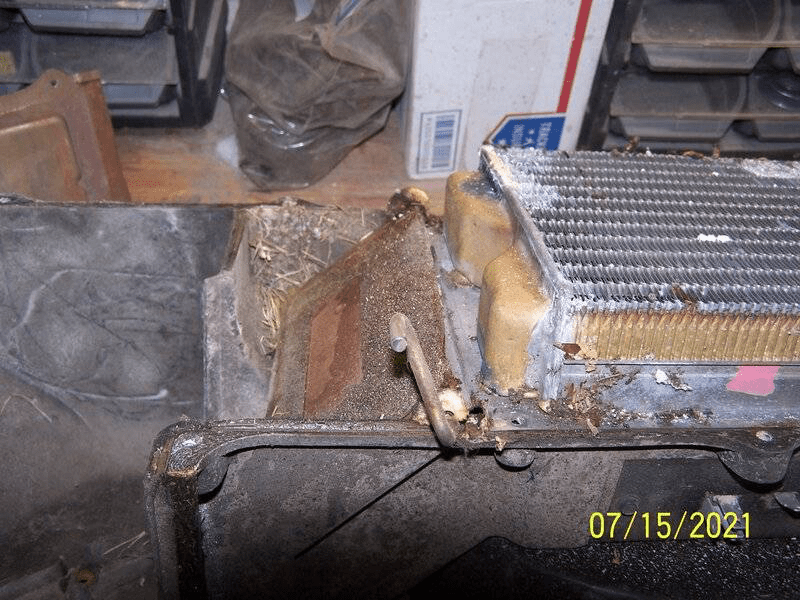

If I remember correctly, there is about a 1" gap between the outlet of the heater box to the defrost vents tube. I don't have a photo from my Charger but here's twofrom my 71 Challenger showing the gap.
