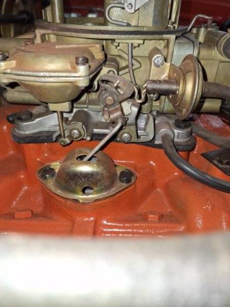

Make sure the choke sets properly and the fast idle cam gets set on the carb.

Thanks for all the help everyone, it was indeed the ballast resistor, pretty much started right up. Might have a few other small issues I need to address however. First off, the choke kinda seems stiff and kinda stayed shut making it a little difficult to get it dialed in. Can someone please verify that this is how the choke should look? Kinda looks a little more skewed than it should be I would think, but what do I know?...lol Also I'm assuming the switch on the clutch pedal is going bad, the one that allows the ignition to crank the engine when the clutch pedal is depressed. When the vehicles warmed up, it hardly seems to work, you depress the pedal, hit the key and notta. Anyone know where to find a replacement, can it be rebuilt, can I just bypass it?
