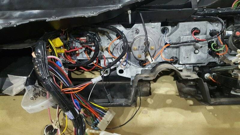

The light never worked since I picked up the car. There is no radio and the heater controls all work with no issue. I don't have a gauge to test the fuses but am willing to give it a shot. Thoughts on where I can grab something cheap? This is all very new to me so I am learning as I go.
Here's a photo of the back of the dash if you need one for reference.
