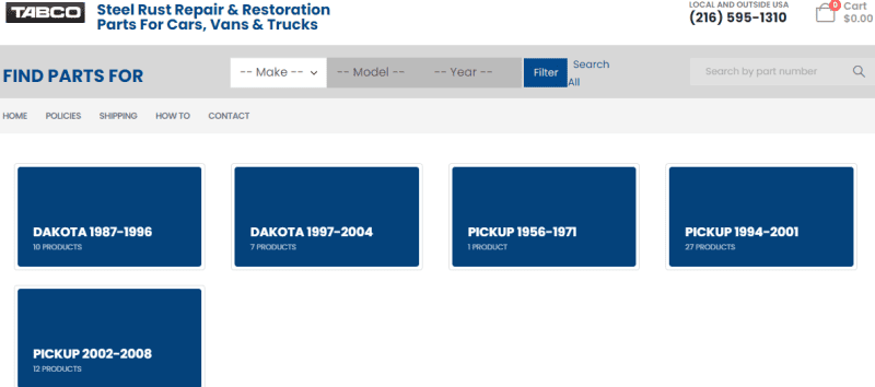

Hello YY1, have you tried Tabco? Just got my left side quarter panel and the quality looks really good, maybe they can hook you up
Thanks, but they don't even list that body style ???
