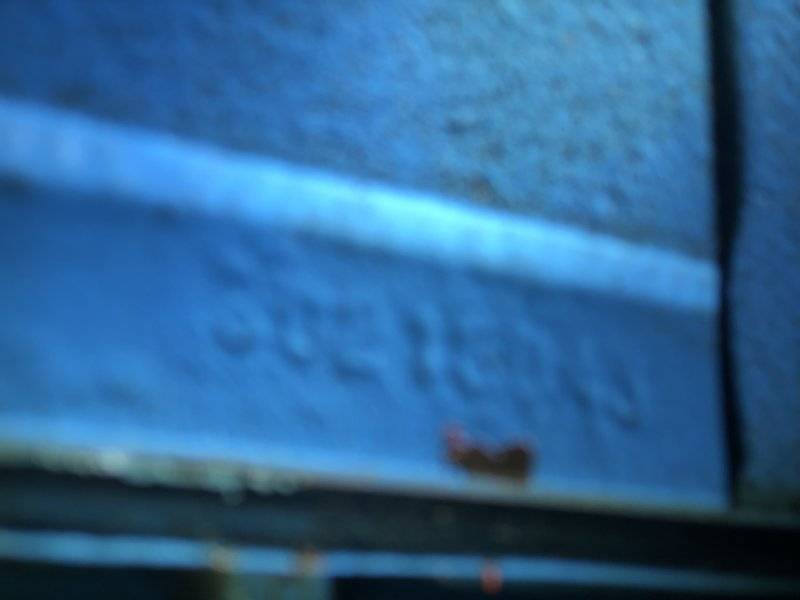

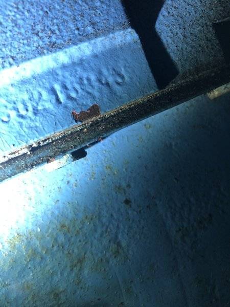

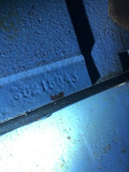

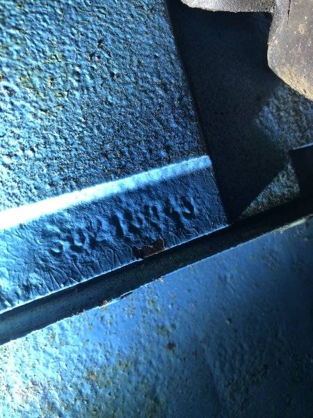

Good afternoon all, have a 72 440 car with a 3698830 block dated 1 16 73, upper pad has 1 24 and an E2 on the exposed part of the pad. The Number stamped into the lower rail is what looks like S 0215348. Is there any chance this is a late release. The build date is 8 31 on the broadcast sheet? I’m guessing it’s likely not the original motor but the S in the serial number on the block has me wondering. Also, read several posts that discuss how blocks were selected from the storage yards???

Your positive that’s an S
Thats why I asked you to scrape the paint
