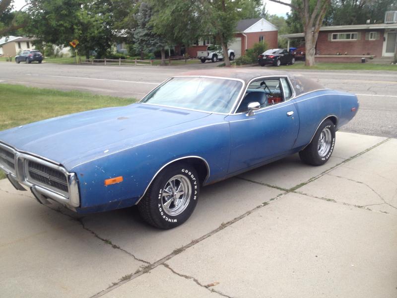

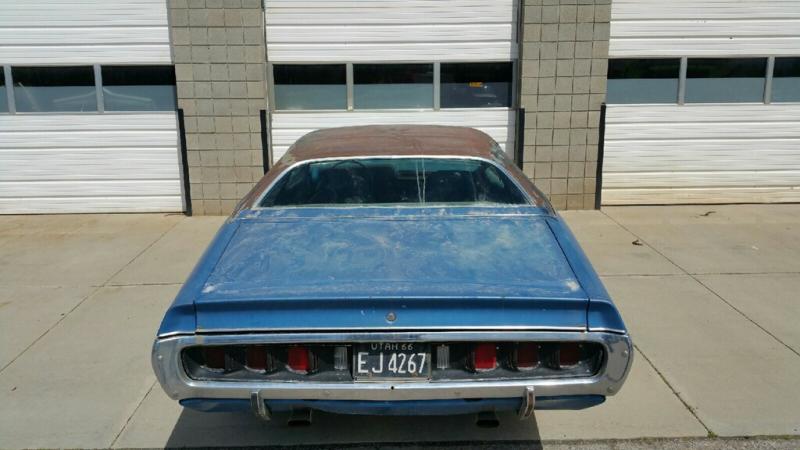

It's been a while since I've checked in. I figured I'd start a new thread in this section to talk about my restoration project. Here's what my car looks like right now [pic1 pic2 pic3 pic4].
My goal this year is to do as much body work on my own as possible. I've been watching body work tutorials on YouTube for the past few months to get an idea of techniques, tools, and things to watch out for (safety, etc).

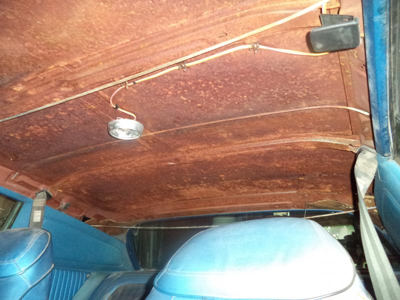

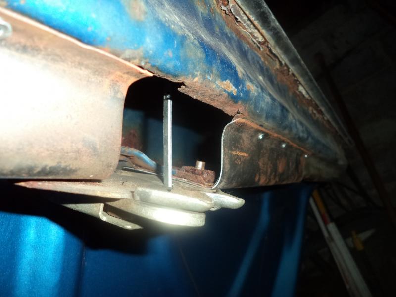

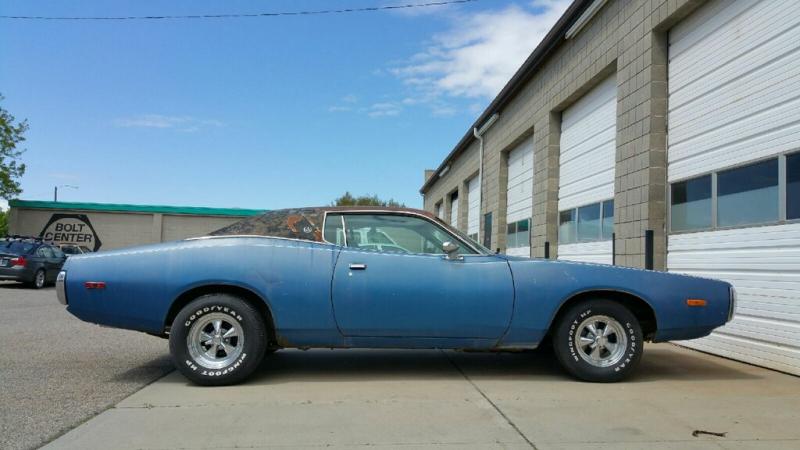

I'm currently looking for a rust-free trunk/deck lid. If anyone knows a seller I would be most appreciative if you would hook me up. Here's what the edge of my deck lid looks like now [pic5]. Yikes! I'll have to strip the whole thing down just to get out all the rust. Also the underside of my roof is starting to get a lot of rust [pic6]. Any recommendations on how to clean this rust out? I thought I'd start with a wire wheel and then perhaps tape some plastic around the bottom parameter and use a sandblaster to get the rest of the rust out of those nooks.
Love perusing these forums. Keep up the great work!
For the roof, I would use a "rust converter" (not a rust remover). They are available at Twilight Zone & O'Smiley's, etc. They look like watery Elmer's glue and you apply them with a cheap paint brush. They react with the rust and turn it black after a day or two.

Both of my trunk lids are much better then what you have there
72 S.Es with the huge C pillar are very cool cars I imagine the vinyl top trim would be hard to find for that and is the passenger fender on that car a 73 74?
I assumed it was from a '72. I'm also not interested in replacing the vinyl top. I'd like to simply repaint the top the same color as the body. I want to start with a matte black and go from there. Maybe work in some very small graphics or pin-striping. I'm really into ice hockey. I was thinking of working a "hockey jersey" theme into the paint job. Was gonna take some pictures and fool around on Photoshop with some ideas.
I have some rust converter ordered and in the mail. If it arrives this weekend I'll strip down some of the interior and paint the rust converter wherever I can find some rust and treat the affected areas.

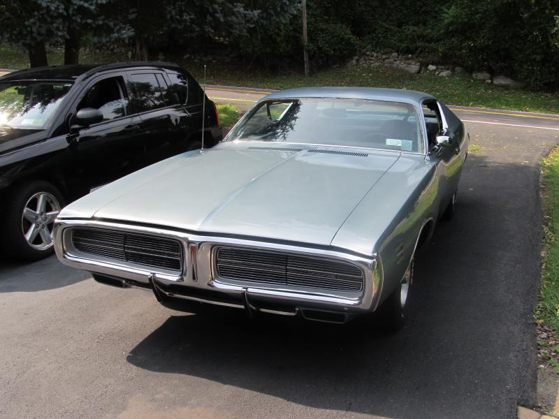

Here's a pic of my newly painted 71 during reassembly and before installing the vinyl roof.

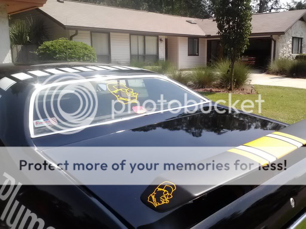

I did something similar with my Roadrunner, except I went the Steelers route with mine. I painted the car black with Steelers gold accent items and used the Steelers sleeve stripe pattern to tie the front spoiler to the rear. I also had custom Roadrunner decals with the Steelers helmet, vice white racing helmet, made up.
Those are both great looking. Love the stripe on the side and the decals, Bruzilla! I've hit a bit of a snag. My Hurst shifter cable took some heat damage and failed on me. Now the car is stuck outside my apartment. The new cable arrived last night. After getting under the car I discovered the cable is too close to the exhaust headers so I ordered some header wraps to help shield the heat.

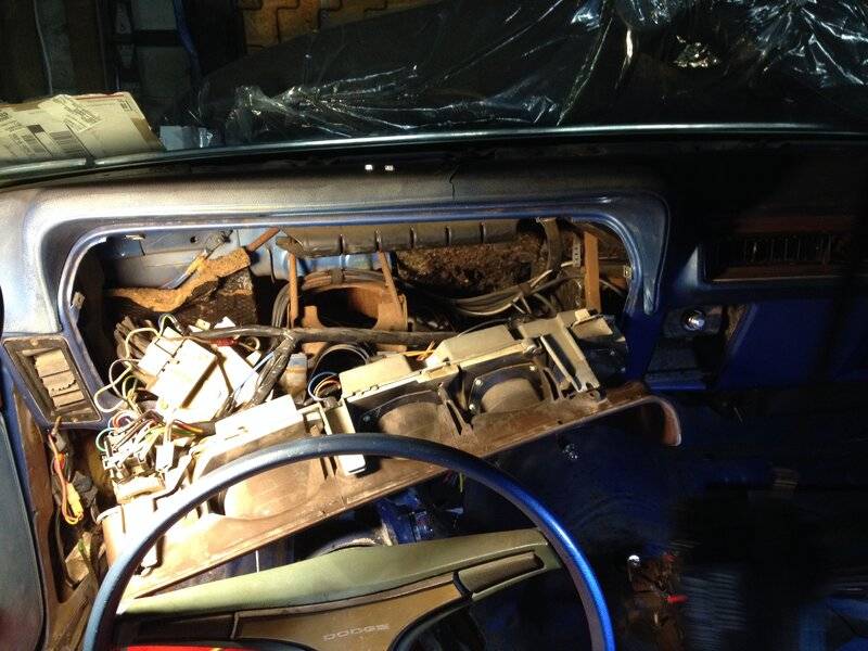

Compression looks great in all 8 cylinders. Each cylinder holds about 150 PSI. Fuel pump sounds a bit "tired" when I turned the ignition switch on. However, this time the ignition switch wasn't engaging the starter solenoid relay. I confirmed the starter was working by shorting out the terminals on the relay, which turned the motor over just fine. However, when I jostled the electrical bulkhead connectors (the wiring harness connectors at the firewall) to make sure I had a good connection, I lost all power to the cab.
I spent the next day or two using a volt meter, trying to trace the source of the problem. The day the issue occurred, I made a mental note that the dash light would partially go out when I turned the ignition switch. I confirmed that the hot wire coming in from the firewall had about 12 volts, all the way up to the ignition switch.
So today I went by an AutoZone and picked up a new ignition switch and a steering wheel puller kit. Once I got the kit off, I realized that my last mechanic had already replaced the ignition switch with a brand new one. So I figured, while I had everything pulled apart - might as well check the voltage at the switch.
1 volt. 1 volt!?
I went back down to the bulkhead connector and tested the "batt" (battery) connector at the bottom of the fuse box: 1 volt. (Where am I getting an 11 volt drop?). I even checked the bulkhead connector lead on the interior side. Still 1 volt.
So I go back under the hood and re-check the connection on the engine side of things. 12 volts. There has to be some kind of issue where the leads are connecting through the bulkhead connectors. Perhaps something got loosened up or some grease got in between some leads. That's the only explanation I can think of that would cause this kind of resistance/drop in voltage.
I fear that I'm going to have to pull the dashboard back out and clean those connectors one by one. Such a chore!

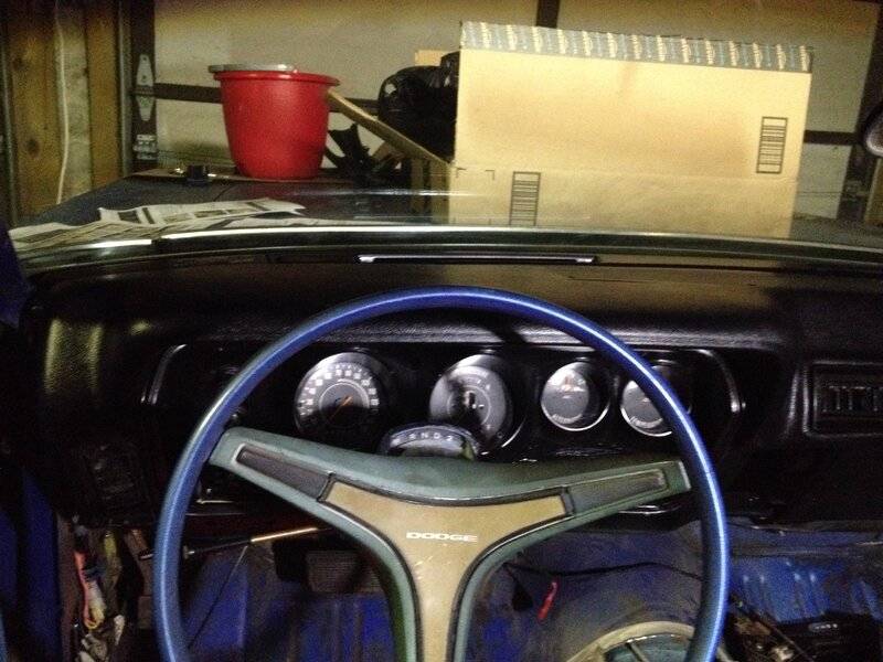

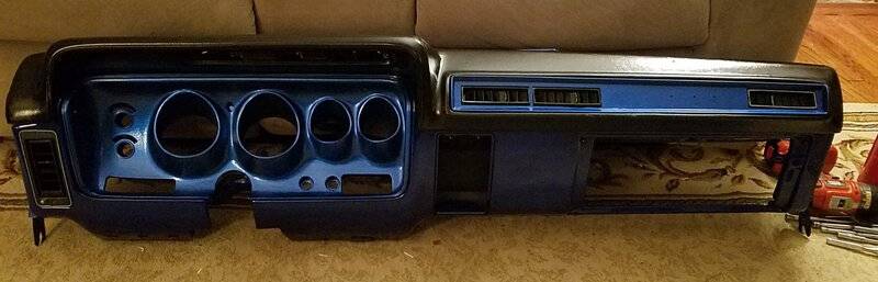

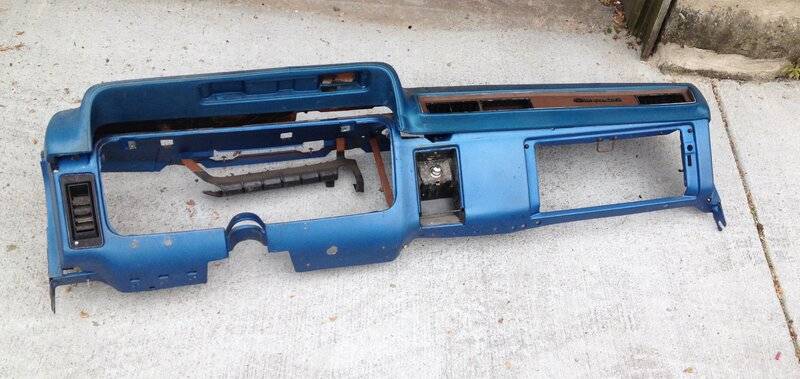

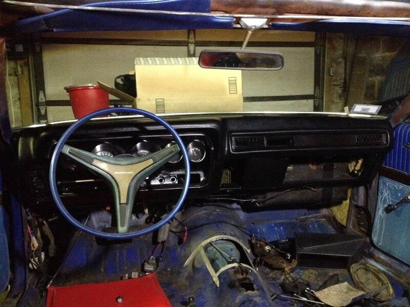

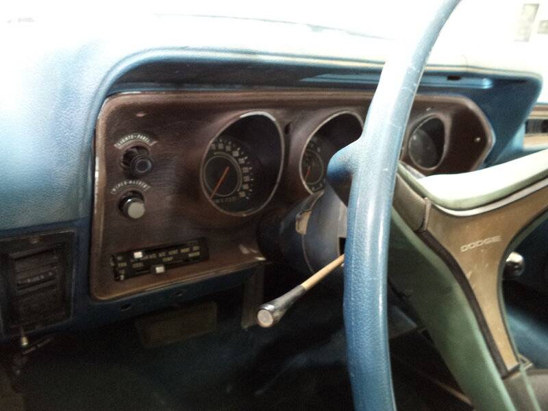

I'd say the most notable thing I did was remove the dash to replace the dash pad. While I was there, I figured I'd resurface the metal of the dash, then throw a few coats of black color and clear coat paint to give it a nice finish. I also sanded and painted the gauge cluster because I wasn't a big fan of the faux wood.
Attached are some before/after pics of the dashboard!
I also took out the bench seat, as it has been almost completely ruined from being exposed to the elements for a few years. I bought some aftermarket bucket seats and "constructed" (e.g. cut a 1" square bar of aluminum) to fit in the seat bracket, so it would be level. "Universal floor bracket", my rear end!
I'll take pictures of the new seats when I put them back in. I took them back out today to start taking out the dashboard again. I put the dash back in for a fitment check and didn't bother to reinstall the lower quarter plastic pieces under the A-pillar, which have to go on before the dashboard. Taking out the dash will also make servicing the interior bulkhead connector *much* easier when my cleaner tool arrives!

Nice! I never cared for the fake wood ether . I always painted mine . The dash looks great .
Don't like fake wood either. LOOKS GOOD CHICAGO!!! Ya shouldve gone Orange & Black as a hockey theme thou, FLYERS!! :D
