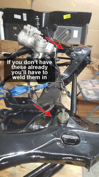

Yes. Either find a factory setup with the LCAs or look at Fermfeel and Hotchkiss. They have kits with bolt on brackets for the LCAs.

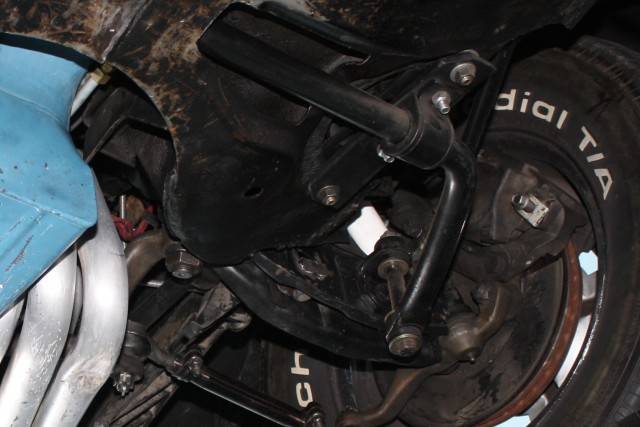

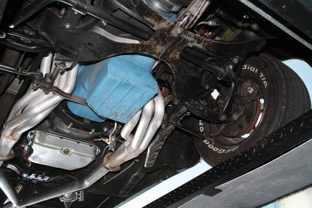

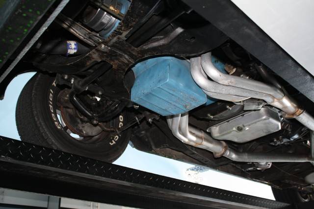

I went with Firmfeel, although i had a sway bar and upgraded it to the 1-1/4 Firmfeel one, they do sell the brackets you would need to weld in.

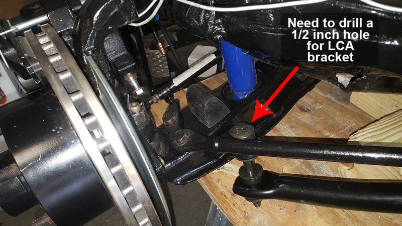

I am using Hellwig sway bars front and rear. My 72 did not come with sway bars either. The front is all bolt on, no welding unless you want to. Just have to drill a hole in the LCA to mount the sway bar end link bracket. The K frame side is all bolt on.
