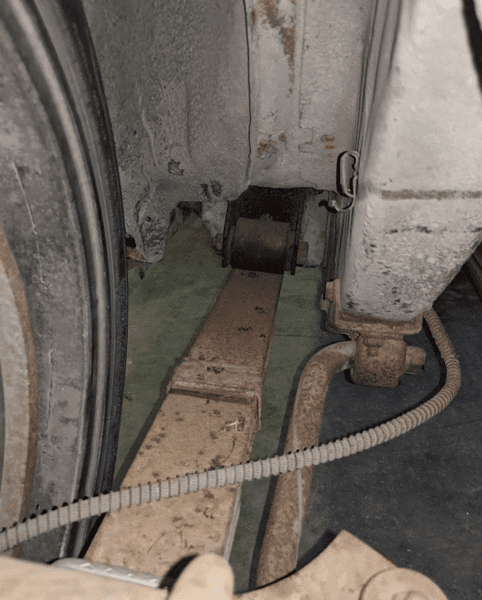

Ok I've done some look'in and I have found relocating the rear springs inward, but nobody mentions what they did with the rear sway bar?
I might be able to move inward 3/4" and use the factory sway bar but I'd like more.
The easy route would be to go without the sway bar but I don't like that option.
Anyone else run into this?

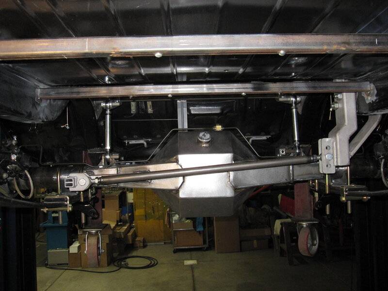

I can't report on performance but a antisway bar is a antisway so I installed a drag race style antisway bar time will tell if it works but I think it should. It does cut down on unsprung weight.
Mike
