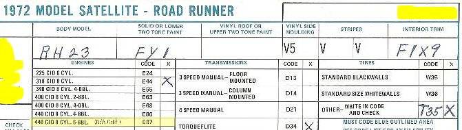

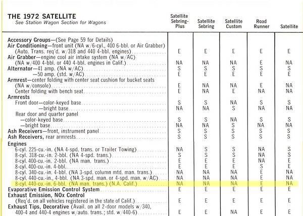

Early data books, order sheets and sales materials all show the 6bbl WAS going to be offered for 72. Early, like first week of production early, the engine was dropped due to not passing emissions standards. There are a handful (5?) of known 72 440-6bbl cars. They were supposed to be built and they were built.
BUT...if anyone claims they have an original 72 6bbl car built after the first week of production be prepared for serious scrutiny and likely a disappointment. Be prepared to offer a broadcast sheet, window sticker or rock solid documentation on the car.
No pics allowed = really suspicious. "Z" would not be necessary as "V" as already assigned to the 6bbl in 72.
Data books shows the four speed was to be N/A with 6bbl. 4bbl only.

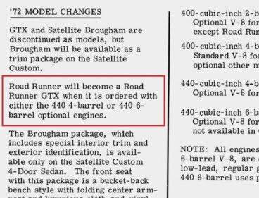

Found this over at the roadrunner nest:
No such package, there was never a package or option officially titled “GTX” for model years 72-74’. Simply, if you ordered a Road Runner with one of the optional 440 engines, the car was called a “Road Runner GTX” ,using the RM vin prefix, came with dual badging and a higher trim level similar to the 71’ “Satellite GTX”.
