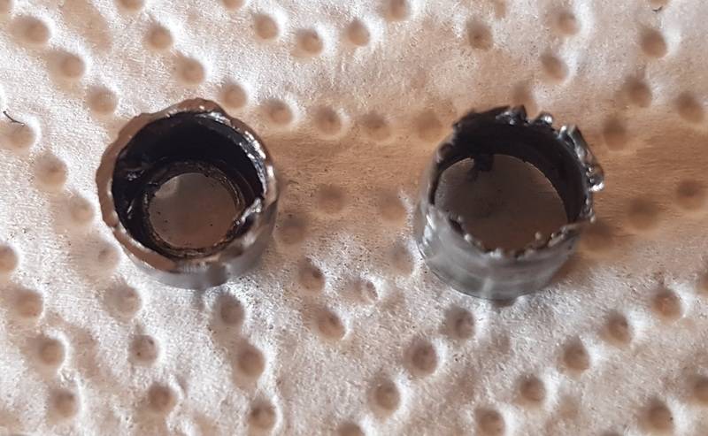

Update: Flare up is fixed. Im writing down what i did and what i found in case someone has a similar issue and finds this thread in the future:
Been draining the transmission oil + dropping the valve body about 4 times now for the past 2 days. To my surprise i found 2 restrictor plugs in the same hole behind each other. One that was punched-in almost all the way to the bottom with the restrictor hole punched-through and another one that was only halfway in and then grinded off flush. Looks like they had trouble getting it in.
They looked like this inside the transmission. I didn't destroy them in the process of pulling them out:
As suggested, i ended up tapping a 1/8" - 27 NPT thread and then used pipe plugs with various hole sizes. The original plug had a 3.5mm hole (~0.14"):
First test was with a 3.7mm hole which already made it slightly better. I went with increasing increments and ended up with a 4.5mm hole, which made a very quick and crisp shift up to about 7/8 throttle. But there still was a flare up of about 200rpm at fullthrottle. In the end the hole would have had to be larger than the hexagon inside the plug so i ended up removing the restrictor plug alltogether which seems to have fixed the problem without any noticeable downsides in part-throttle shifting.
Getting the valve body out was sometimes a hassle. I found out that rotating the rear wheels until the parking pawl clicks in made it significantly easier to pull it out.
Thanks everyone for the help
