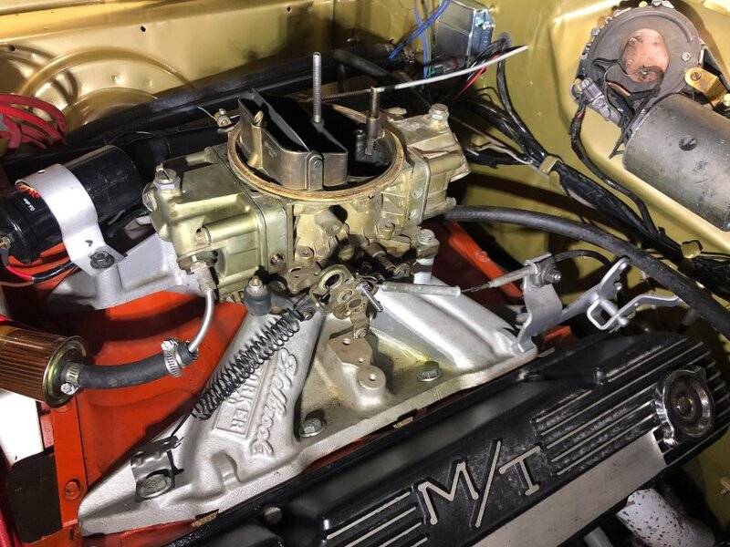

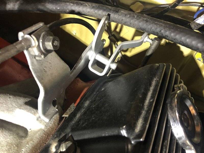

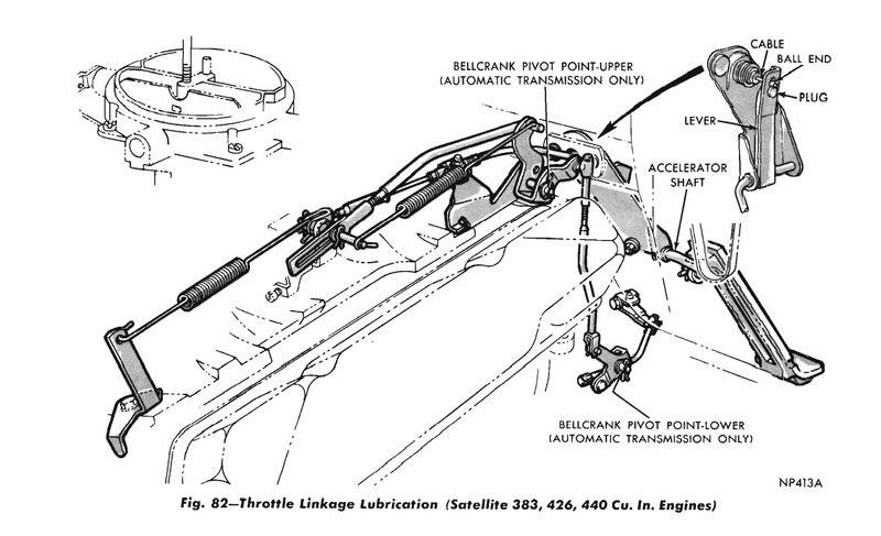

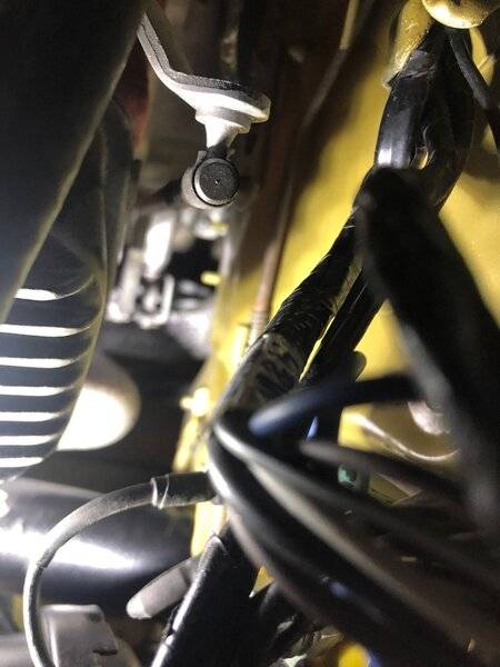

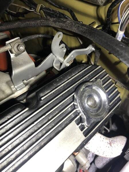

OK taking a step back. Yes I'm missing ALL the topside linkage for the kickdown. The lower linkage to the transmission appears to be intact and connected. Here are more pics and the diagram from the 69 manual. Love to hear more about the kickdown function? Also note the angle of my throttle cable because of the manifold height

The bracket looks totally wrong to me. Here is a pix of my linkage bracket from my 71 bee 383HP w/holly carb.
They changed the design. My 71 Cuda was pretty much identical to the 68-69 B Body linkage. Here is a 6 pack 440 and the 69 service manual
