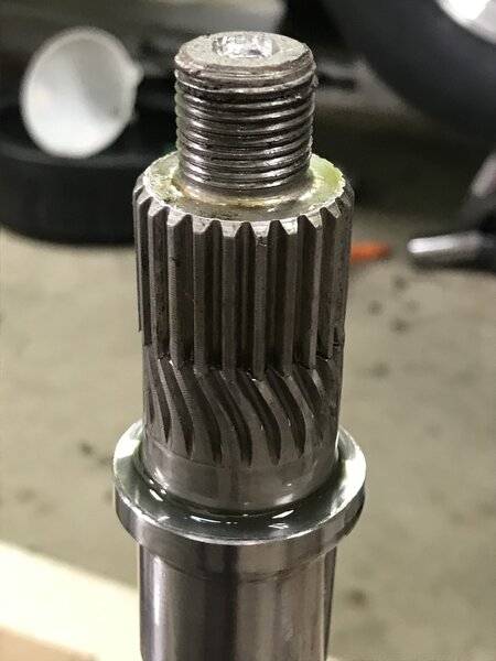

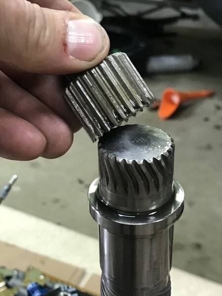

I destroyed one of those long ago at 650hp and 4200lbs. I’m running the billet steel 5 pinion.
Heavier cars are harder on parts. Kim
Definitely
