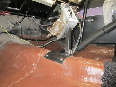

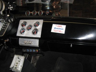

I will NEVER give up my P/B shifter!!!!!!!!!!!!!!!!!!!!!!!!!!!!!!!!!!!!!!!!!!!!!:grin:
