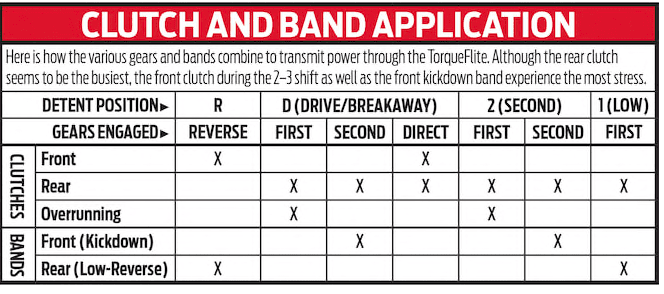

The fact shifting out of manual low releases the lock up proves the rear band is working, it applies & it releases... That means something else is applied/locked when in 1st gear...
Rear clutch is supposed to be applied in 1st/2nd & Drive... If the front band is applied it wouldn't go into 1st when taking off....
You need two elements applied to create a gear... Three elements applied locks the trans... Think trans brake...
That application can be caused either in the valve body or a part can mechanically fail in the applied condition....
Thanks for that chart. I'll pull the pan and remove the valve body. I was thinking thats where the problem lies but wasn't sure. I may just order a reverse manual and put it in.
